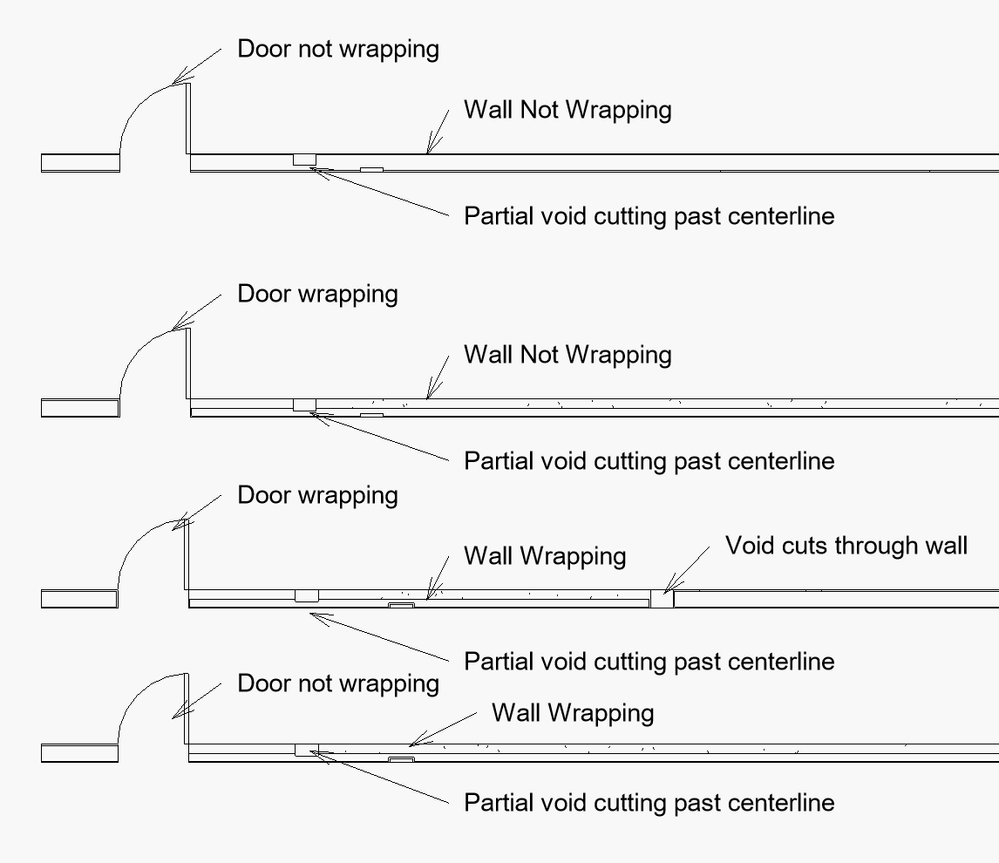

When a family with a partial void (such as for a wall niche or recessed equipment) cuts the wall, and that void passes the center line, and another element or the wall itself have wrapping turned on the appearance of the layers breaks and the outermost layer enlarges to the centerline or defined wrapping depth.  This graphical error is apparent in 2d and 3d views that cut the void.
Please correct this error so that partial voids of any depth can be used to cut walls.

It would be nice if Autodesk would fix this wall layer wrapping bug before finishing wall features and moving on to new features.
DavidsDesk
I do not see it documented but this looks to be fixed in Revit 2023.
fg
I don't know about Revit 2023, but still a problem for Revit 2022.  A bug like this should not be subject to a "vote" and ignored for seven years, it should just be fixed as soon as possible.
