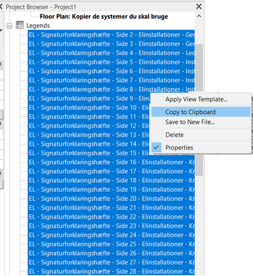

ViviNyehuusAndersen
Please make it possible to copy legends to clipboard and paste them into another project.
Just like, we can do with schedules 🙂
ViviNyehuusAndersen
Still not possible to copy to clipboard and paste legends into another project.
lionel.kai
@ViviNyehuusAndersen Actually, it is possible in 2020: you just have to copy between Sheets (which may mean making "dummy" sheets, if needed).
ViviNyehuusAndersen
wow Thanks a bundle😊
Did not think at this, now I can place all the legends in one sheet and copy paste them into my project.
Love it👍🏼

ViviNyehuusAndersen
It has not bin implicated!
They need to add copy to clipboard and paste available for multiple legends.
Time is valuable, and workarounds don’t pay of.
