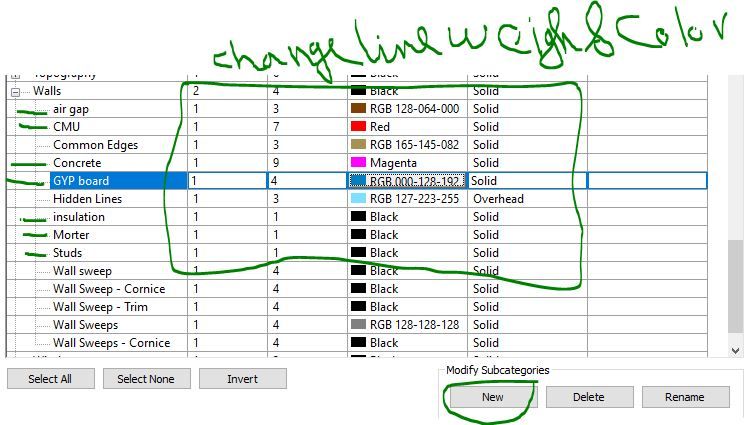

i want to change the way used in revit to change light wight for walls, floors & ceiling layers ,
let create any sub categories i want in object styles and assign to them the line wight as i need then assign those sub categories to walls layers it self so i can change its line wight in each view
- adding all ub categories i need & change their line weight & color (this already allowed by Autodesk)
- assign the sub categories while creating the wall, floor & ceiling types to control its line weight in each view (plans, section & elevations)
this will give me all the control what i need to adjust my sheet and view presentation
