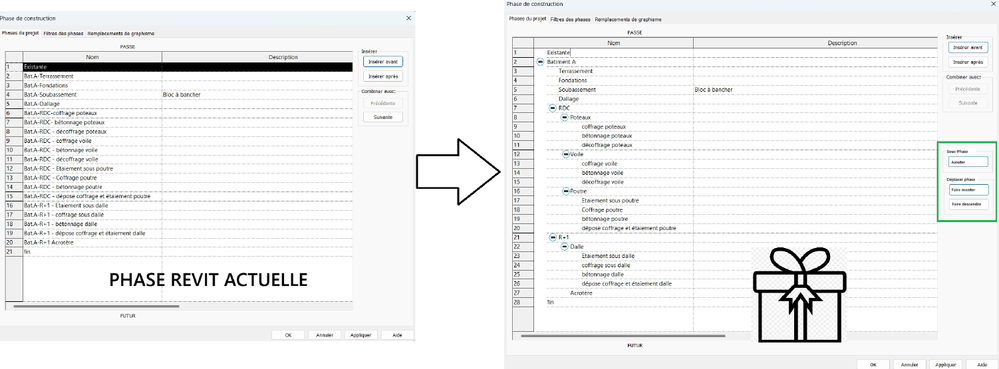

julien_moreaux
I have some ideas that will help the drafter methods:
- Creation of a future phase (same as existing phase, temporary phase, new phase).
- Creation of phase subcategory for general phasing and detailed phasing.
- Access via API to the phase description.
- Add a schedule with Phase.
- A filter "equal to the phase of the active view".
- Add some pretty arrows ↑ ↓ to rearrange the order of the phases.
