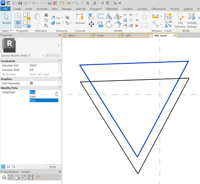

MiWolff
Isn't that what this property is for?20260910_074438-Autodesk Revit 2027 - [Family1 - Floor Plan_ Ref. Level].png
david7K7DR
You're right — I completely missed that property. I had previously tried converting geometry in a context where the option wasn't available and incorrectly assumed Revit couldn't do it generally. Thanks for pointing it out.
