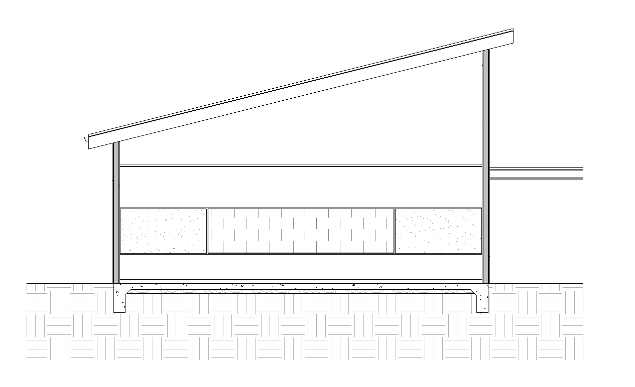

I'm using Revit 2017 and I'm having a weird problem using split regions in wall assemblies.  I'm using Split Regions to show horizontal score lines on the exterior of my building.  See attached snips for this.
The problem is when I go to a Wall Section, my walls either partially disappear or the cut patterns don't show correctly at all.  I've checked phasing, filters, coarse/fine, but the only thing that "fixes" the problem is when I remove the split regions from my wall assembly.

Never had or read about the issue you are describing.  Interesting.  Might be a local phenom. Want to post the file for us to look at?
It works here.  Can you copy the wall to a new file and share it?
I noticed my functions were not set to the same setting for the plaster.  I had one at Finish [4] and one at Finish [5].  I re-did the split regions with the wall materials all matching function [4] and it worked!
