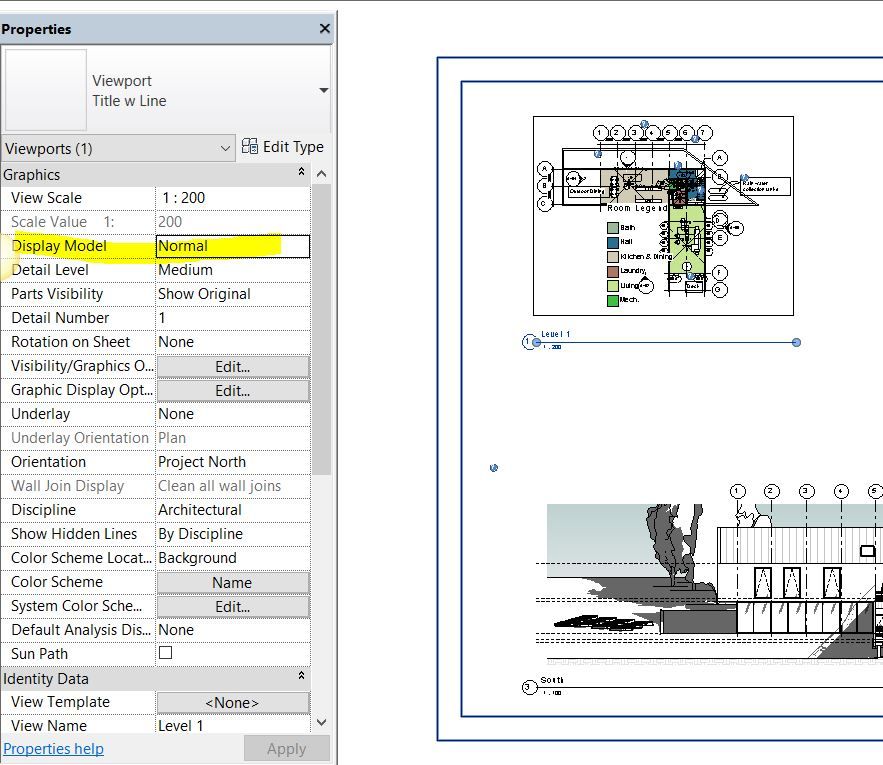

1) We do have a display mode in Revit 2015, see image below

My display model is set to normal, this option only comes up on plan views and elevations, not renderings or sheet views.
When I printed 1 view it printed the same as the most bold view on the sheet with 4 views, whether raster or vector, it printed the same way.

  • You can also try to change the view depth and the visibility of the linked files to be "by linked view".
  • Try our downloading the software from Autodesk virtual agent - download links
Let me know if any of the above recommendations resolves your issue. Looking forward to your reply update.
