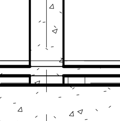

I loaded in a structural column family so that I could include the capitals in the model. I replaced my architectural columns with these.
When I removed the architectural columns, the boolean cuts I made to the floor disappeared, so I changed the floor to a structural floor and then the column/floor interaction automatically looked like this:
I don't seem to be able to manually cut/join the two structural elements.
I eventually have to add thickened slab edges around the columns, as well as around the perimeter of the slab at the bearing walls.
So how do I fix the graphics to appear like the condition with the architectural column:
Thanks for your thoughts and assistance.

Make the Medium or Fine Geometry visible in Coarse View in the Family. Then you can Join to Floor in Project.

You need to use Join Geometry, not Cut geometry.  Then switch the join order accordingly.

Use the actual Switch Join Order tool.
Message 10 of 14
Looks like it Joins, but in the incorrect order. Switch Join Order.

Great, thank you.

Join geometry.  If the slab stops at the walls then switch join order.
