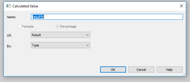

You will need to create two different calculated columns to do some math...
1) First go to the Formatting tab for the Result column and change the drop down under Field formatting: to Calculated totals
2) create a calculated parameter (result%) that is the percentage of the results column by the <Grand total>, again go to the formatting tab and under the Field Format... change Units: to "General" .
3)create a calculated parameter Type: Number and under Formula: roundup(result%). this should then give you the rounded up number of the grand total of your base result column.
you can then hide the first result column and the % column. and un-check itemize every instance and get the following...Capture2.PNG
Nachricht 13 von 32
als Antwort auf: Anonymous
edit formula...
3)create a calculated parameter Type: Number and under Formula: roundup(Result/result%)

You were correct, the method I suggested did not work. However after replicating your schedule I think I may have come up with a solution. Its not a pretty formula but I think it works. I still created a (result%) based off of the Result column only instead of it being <calculated total> I selected <Type>. Then I created a calculated Parameter "Rounded Result" with the Formula: (roundup(Result / result%)) / ((Result / result%) / Result)
see images below... as long as the Rounded Result column has calculated totals checked under Field Formatting: it works. Also I removed any field formatting for rounding decimals from the "Result" parameter. Capture.PNGCapture2.PNGCapture3.PNG

rvtquestions
Thank you @Anonymous
Seems to be working!
