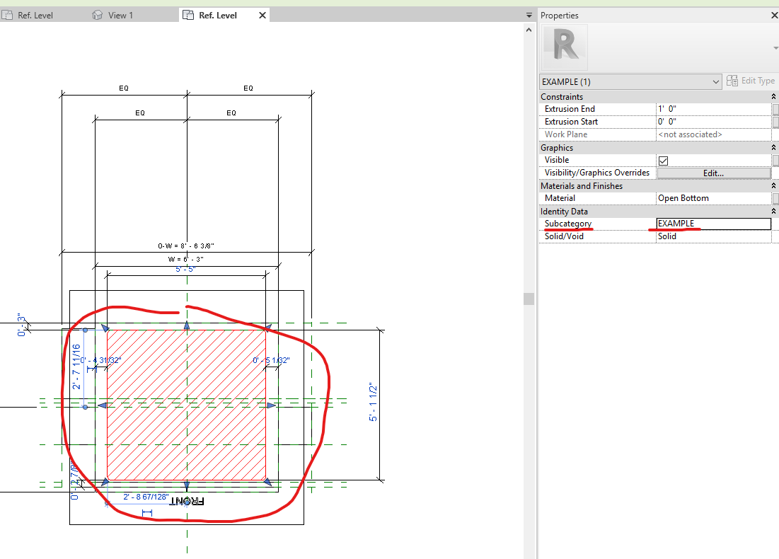

This is what I am talking about its hard to describe. So I took some screen shots.
Most of the prep work is done in the family before export.
This workflow works for me when exporting DWG file and placing them into navis works.
I hope I am understanding what you want to do correctly and not sending you in the wrong direction.

@Anonymous Man! you've saved me so much trouble. this is exactly what I wanted.
Thank you so much!!!
