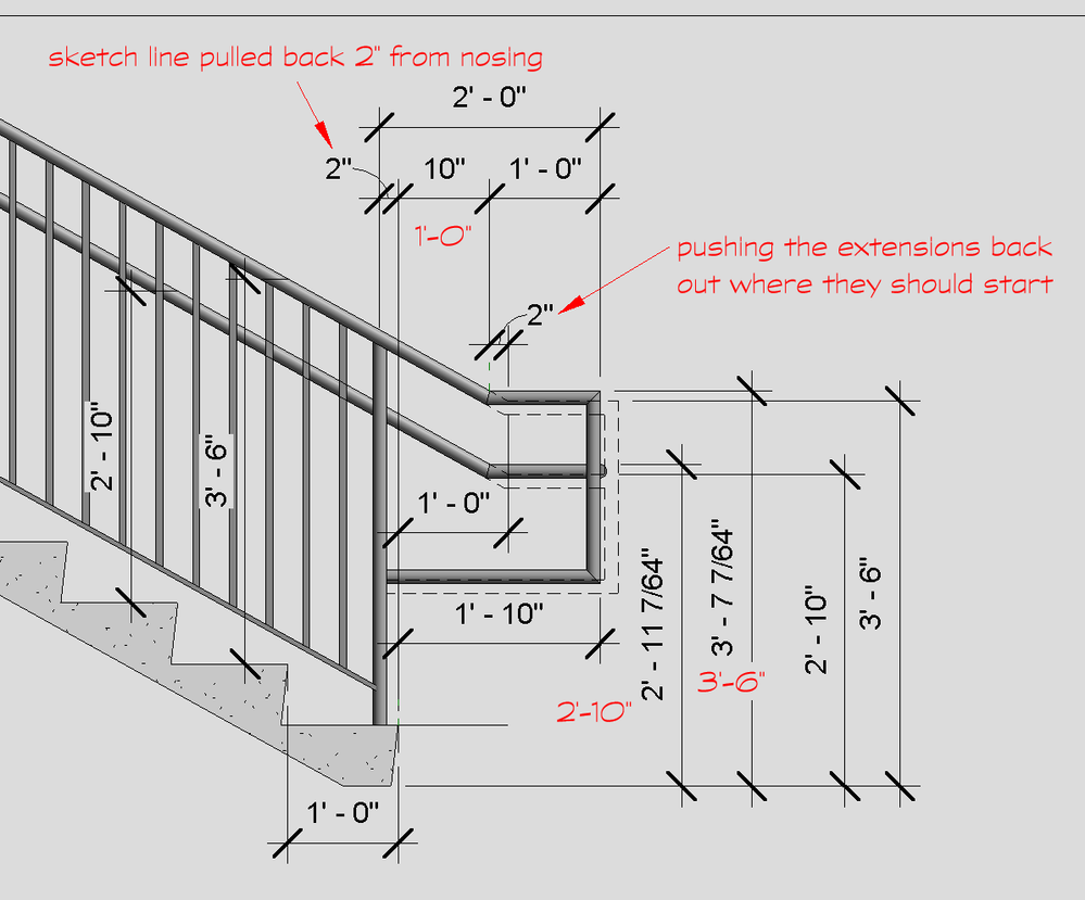

As shown below, when I ‘space’ the end post of my rail system back 2” to sit on the stringer, the bottom rail sticks out. Is there a setting that corrects this?

Why don't you shorten the railing sketch line instead of moving the baluster?

srooney
This solution does not work, as it shortens the calculation point for the upper rail extension, so the the extension is no longer the code distance from the nosing.  Checking the "post" property on the baluster type is supposed to trim the rail to the post, but this does not seem to work either.

The solution addressed OP query specifically.   If you are not satisfied then create  a new thread to ask for your condition.  By the way, the rrail extension can be lengthen to any dimension you want to meet code.

srooney
The question was directly pertinent to my problem, so no need to start another thread.
If you shorten the sketch line, and make the rail extension longer to account for this - the extension starts horizontally
at the end of the sketch line, so you will have too much horizontal.
The OP should at least be aware of this.
If this is the only "solution" on the forum, then the actual
solution as usual is for Autodesk to improve the railing tool, instead of us all having to make a work-around,
which is certainly not your problem.

TheMattatonAP
@ToanDN what were your settings to achieve this image? I share @srooney 's concern that pulling the sketch line back introduces inaccuracy in the extension.
