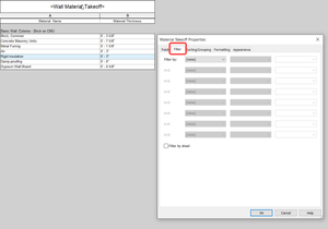

Working in Revit 2021:
I am trying to use the material takeoff schedule tool to create a construction assembly for each wall type.  I have most of it working, but noticed that multiples of materials in the assembly are only showing up once.  See screenshot:
I have the "Itemize Every Instance" box checked in the sorting/grouping window, but that does not seem to make a difference:
The only workaround I have been able to come up with is to make a new material for where I have double layers in the assembly and use the comment section to describe the intent, but this does not solve when I have separate layers of the same material (on either side of a typ stud gwb for instance only one layer of gwb shows up).
Would it really be too hard for Revit to just give me this exact information as a schedule as I created the project walls?

Create Parts and schedule Parts.

Duplicate Material: Marks?  Filter?

Thank you for taking the time to look at this.  I have done as @ToanDN  recommended, but I now see that the only material information available in the Parts schedule is the title of the material.  Is there a way to pull the takeoff material schedule fields into the parts schedule?
Further: is there a way of indicating the "layer" number as a field as shown in the edit assembly window?

@daniel.jolivet wrote:
I am not sure how to do what you are suggesting.
My understanding is that the MTO was inaccurate. I would immediately suspect a Filter is the culprit if it were me.  Maybe I misunderstood.  Dunno. But Wall MTOs are pretty fool-proof.

Just to be clear, I'm talking about schedule filters.
Message 9 of 20
daniel.jolivet
Yes, thank you, that is where I am looking.
Would you do me a quick favour and try adding a couple layers of GWB to your assembly and then showing that the schedule shows the multiple layers on your schedule? It seems like a simple thing that is just not working for me.

@ToanDN thank you!  I see that I was using the Parts schedule, not the Material Takeoff Parts schedule.
Update: I do not have the option for a Layer Index Field:
Thank you.

I use 2022, which version you are using?  By the way you don't need it because the schedule still shows separate layers of the same material.

I am using Revit 2021, this might be the difference.
Even when I just do the Multi Category Material Takeoff I do not see Layer Index as an optional Field.
