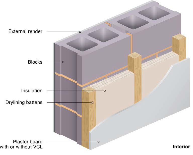

Hi there,
Can anyone tell me how to make hollow core concrete block on Revit Architecture 2015? I think I may have to make my own family but then I really can't find the suitable template to make it. I want to model a house with a composite wall, concrete hollow blocks on the outside and timber battening with insulation inside.
Would be great if someone can provide a family file or even suggest the correct template for the entity.
Attaching a sample pic of the desired wall type. Please help! 🙂
Cheers!

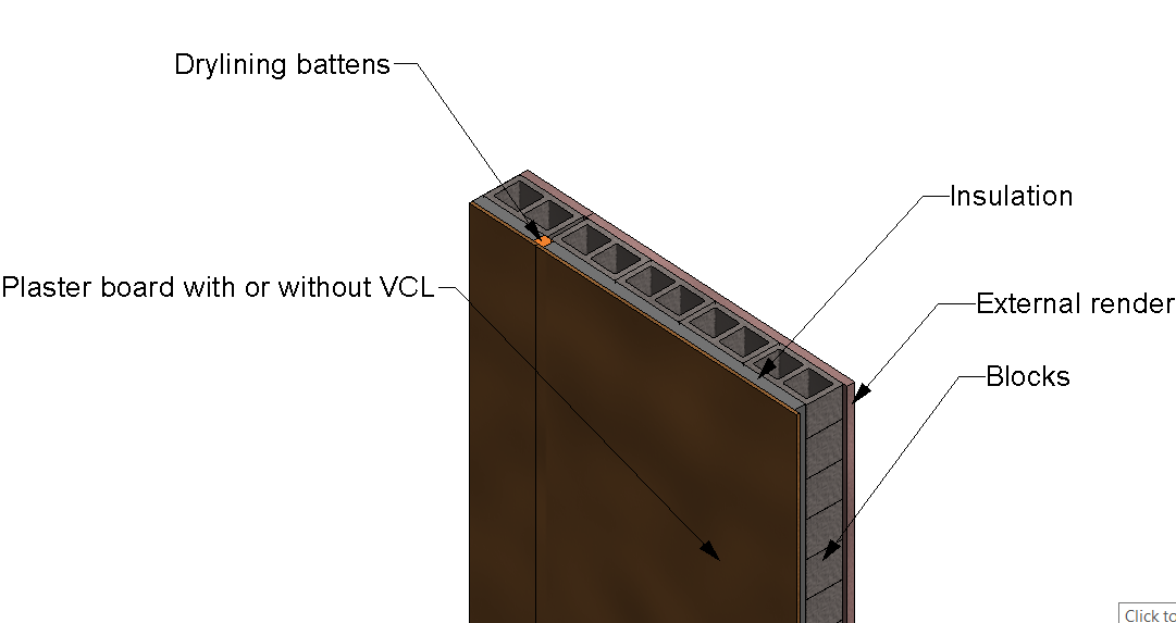

Thanks. I could make the family. But when I load it, I can't see it anymore. I have turned on visibility for the curtain, walls and other layers. However, it is not even selecting it. Under which category can I find the wall now?

I need to model the hollow wall block since I am modelling an Irish house with similar wall properties, at the moment. I know the method that you showed with the assigning of the skins of different materials for a wall, but that's incorrect since I need a hollow concrete block and not a normal one. Later on, I want to import this geometry to energy performance engines (e.g. EPlus) to perform the energy load and consumption analysis.
Message 10 of 24
Yes I need to model the voids in the concrete block. It's a pity that Revit does not have the options embedded in the materials only, since I don't think it would take a lot of effort to put in such a feature. Otherwise, a better family template could help as well to reduce the work.
As for me, I modelled the wall with the required features but when I load it into the project, I can't see it and it's getting 'lost' somewhere. I have all the layers on in the visibility settings, but still doesn't work.

GHASEM_ARIYANI
Process making:
1- Open Metric Generic Model.rft then Create a Block model.
2-now , opne a new family Metric Curtain Wall Panel.rft Template .
3-set panel size fix. for exampel : w = 1.304 and H = 3.872 .
4-Load Generic Model Block into Metric Curtain Wall Panel.rft and use Array tools to multi number parameter.
5-The number of layers, the extrusion tool will create and with Refrence Line Create Parameter .
6- now Load to open project and Create Curtain wall with mullion and set panel size V and H fixed.
7- select Created Family panel in Curtain Panel List in the Curtain wall Type properties.
GHASEM ARIYANI
