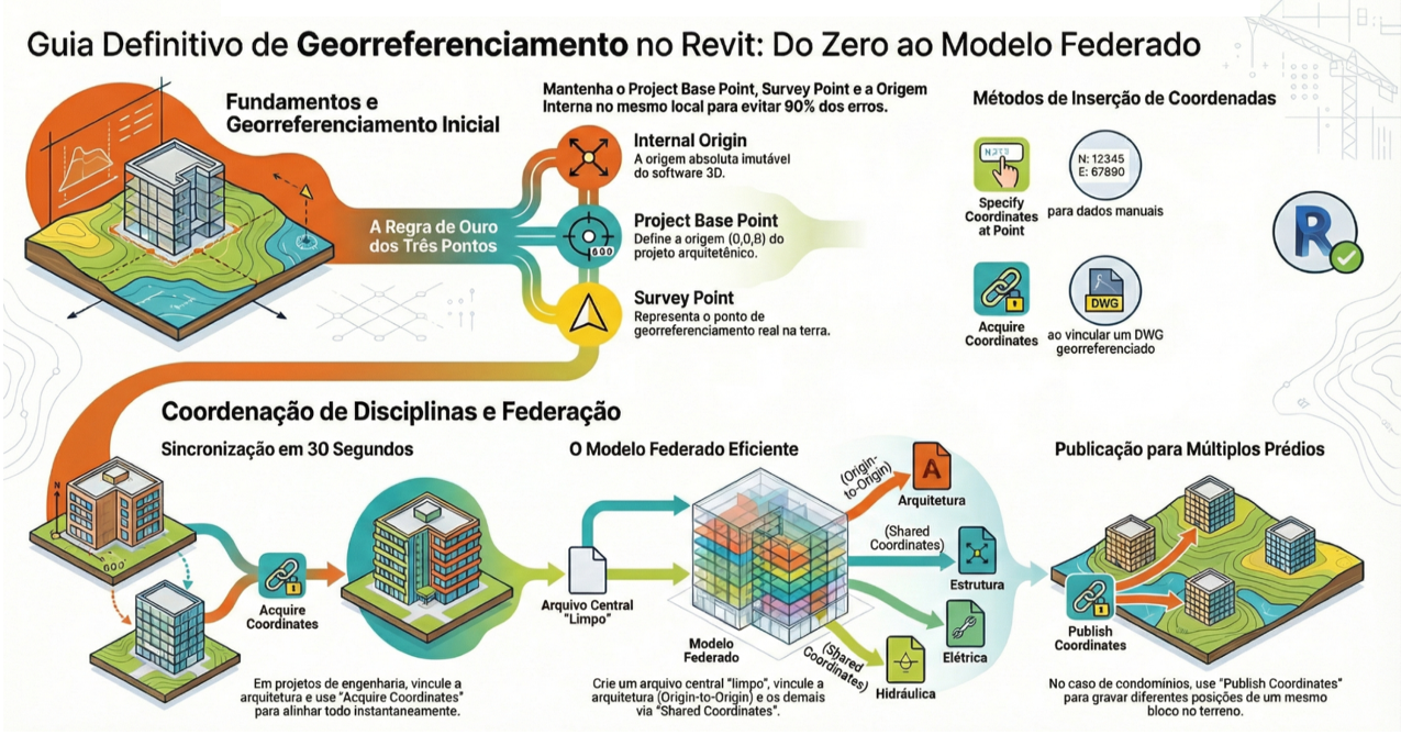

  1. Initial Setup
The foundation of a georeferenced project in Revit lies in managing three reference points:
  1. Project Base Point (Circle): Defines the local origin of the project.
  2. Survey Point / Survey Point (Triangle): Represents the actual georeferencing point on the Earth’s surface.
  3. Internal Origin / Location Line (arrow gizmo): This is the absolute zero point of the software, common to any 3D program.
The Universal Strategy
To ensure the model is properly federated, the primary recommendation is to keep these three points in the same location when starting the file from an architectural template. The project should preferably begin from a building corner or a site corner positioned on these points.
"Keep the three points in the same place and you will solve 90% of any problem that may occur in your georeferenced project. Simple as that."

  1. Workflow for Engineering Projects and Complementary Disciplines
For engineering disciplines (structural, plumbing, electrical), the georeferencing process is simplified and should be completed in seconds:
  1. Template: Start the file using the discipline-specific template.
  2. Link: Insert the architectural link using the Origin to Origin option.
  3. Acquisition: Go to Manage > Coordinates > Acquire Coordinates and click the architectural link.
  4. Verification: Use the Spot Coordinate tool to confirm the values match those of the architecture.

Mind Map – Georeferencing and Coordinates Master Guide in Revit

Guide for Georeferencing projects: Guia_para_Georreferenciamento.png
