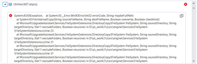

ziggy63
Hi Gilles,
Thank you very much for the guide. I tried to follow your instructions but the upgrade of all my vb projects failed, with the following error message:
Does this message mean anything to you? What am I doing wrong? Has anybody else encountered this error?
Thank you in advance,
George
Message 12 of 70

Message 13 of 70
_gile
@ziggy63 wrote:
Hi Gilles,
George
Never seen that message before. It seems to be an error with the Upgrade Assistant.

ziggy63
So, I seem to be the only person on planet Earth who cannot upgrade a VB project from .NET Framework to .NET, using Microsoft's own tools! Now, this is interesting...
Message 15 of 70
Alfred.NESWADBA
are you sure that you have installed the .NET 8.0 SDK?
I have had messages similar to yours (not sure if that really were the same), before I installed this SDK (I just was looking into the VS2022 installed parts (tools and features) and have seen ".NET 8.0 Runtime (Long Term Support)" aas well as ".NET SDK" and thought, that should be enough. Later I recognized that this is not all that is needed and installed the "real" .NET 8.0 SDK from here: >>>click<<< for downloading .NET 8.0 SDK (v8.0.203) - Windows x64 Installer!
HTH, - alfred -
Alfred NESWADBA
(not an Autodesk consultant)
Message 16 of 70
ziggy63
Hi Alfred,
I reinstalled the SDK, using the link you sent me, but the problem persists.
Thank you anyway.
Message 17 of 70
_gile
No, you're not alone:
https://stackoverflow.com/questions/77932310/net-upgrade-assistant-error-when-converting-csproj-file...
https://stackoverflow.com/questions/78141705/net-upgrade-assistant-fails-on-converting-project-to-sd...
