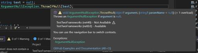

Just wanted to share some experience with a support of AutoCAD Plant 2025 in cases where you have to support multiple AutoCAD Plants' in a scope of one solution.
It is possible to have one project in a solution that works both with .NET Framework and .NET Core by doing this:
1) Upgrade your project to .NET (Core) 8.0. See the instructions above.

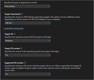

2) Open .csproj file
3) Change the <TargetFramework>net8.0<\TargetFramework> to <TargetFrameworks>net48;net8.0<\TargetFrameworks>
In case you will try to build this project, then you will have two output directories: "bin\net48" and "bin\net8.0". Accordingly, there will be two .dll files, one for each framework. This resolution works great as soon as there is no binary compatibility between AutoCAD Plant 2025 and older versions.
Afterwards, it will be possible to change .csproj to reference required .dll files based on a required configuration. For example:
<ItemGroup  And '$(TargetFramework)' == 'net48'">
 <!--Reference old AutoCAD Plant API .dll files-->
</ItemGroup>
<ItemGroup  And '$(TargetFramework)' == 'net8.0'">
 <!--Reference new AutoCAD Plant API .dll files-->
</ItemGroup>
The only drawback of this approach is that you will not be able to use new features of the C# language. (Sorry for the quality of the image):

Gilles, Jeff,
Thank you for providing the upgrade document, it was very helpful.
I've added additional steps, below, that may help others.
  1. If you plan to choose the In-Place Upgrade option, backup the AssemblyInfo.cs file from each project's Properties folder to a location outside of the solution folder. The assembly information will be lost during the upgrade therefore you'll need to restore it after the upgrade is complete.
  2. Update PackageContents.xml
    Set SeriesMin and SeriesMax to R25.0
    Update all settings that reference the previous AutoCAD version.
  3. By default, the upgraded project's output path will reflect the target framework therefore, the new output path will be bin\Debug\net8.0-windows. If you prefer the output path to be bin\Debug, edit the .csproj file and add the following settings to the end of the first PropertyGroup in the .csproj file.
    <AppendTargetFrameworkToOutputPath>false</AppendTargetFrameworkToOutputPath>
    <AppendRuntimeIdentifierToOutputPath>false</AppendRuntimeIdentifierToOutputPath>
  4. Copy the backed up AssemblyInfo.cs files from Step 1 to the Properties folder of the upgraded project(s).
    The file should show up automatically in solution explorer.
    NOTE: Although you can add the assembly information to the project in the Package section of the project properties dialog, it's very cumbersome and will not work without modifying the .csproj file and setting GenerateAssemblyInfo to true.
    For these reasons, it's easier to copy the AssemblyInfo.cs file from the previous project.
  5. If you use PreBuild or PostBuild events, they will no longer work therefore you will need to
    migrate the the PreBuild and PostBuild events using the following steps.
    1. If the project's Properties dialog is open, close it, otherwise, the changes in the steps below may not work.
    2. Edit the .csproj file by double-clicking the project in Solution Explorer.
    3. Scroll to the end of the file and copy the PreBuildEvent and PostBuildEvents
      then paste the copied content into a new text file as a backup.
    4. Delete the PreBuildEvent and PostBuildEvent elements from the .csproj file
      including their surrounding PropertyGroup elements
      then save the changes.
    5. Open the properties of the project in Solution Explorer.
    6. Select the Build > Events tab.
    7. Copy the PreBuild event from the backup created in Step e.
      but don't include the PreBuildEvent or PostBuildEvent tags.
    8. Paste the copied text into the Pre-build event text box.
    9. Repeat the process for the PostBuild event.
    10. Save the changes.
    11. Verify the changes by editing the .csproj file and scrolling to the end.
      The PreBuildEvent and PostBuildEvent elements will reflect the new
      format for the events. For example:
          <Target Name="PreBuild" BeforeTargets="PreBuildEvent">
              <Exec Command="rem Do something" />
              </Target>
  6. If you load settings from an App.config file, you will need to downgrade the System.Configuration.ConfigurationManager package otherwise the following exception will occur while loading the settings.
    System.Configuration.ConfigurationManager 9.0.0 exception:
    System.TypeInitializationException: The type initializer for 'PPWR.AutoCADPlugin.Globals' threw an exception. ---> System.IO.FileNotFoundException: Could not load file or assembly 'System.Configuration.ConfigurationManager, Version=9.0.0.0, Culture=neutral, PublicKeyToken=cc7b13ffcd2ddd51'. The system cannot find the file specified. File name: 'System.Configuration.ConfigurationManager, Version=9.0.0.0, Culture=neutral, PublicKeyToken=cc7b13ffcd2ddd51'
    Right-click on Dependencies in the Solution Explorer and select Manage NuGet Packages then select the Installed tab and search for System.Configuration.ConfigurationManager.
    Change the version to 8.0.1 or something prior to 9.0.0 then click Update.
