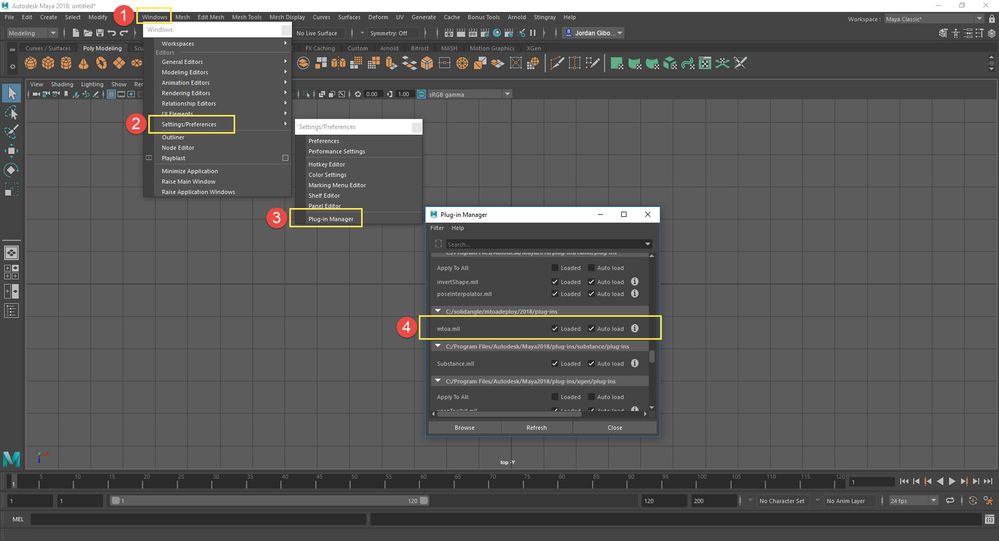

Thanks for posting! The error on the bottom (yellow) is referencing the Arnold Plug-in. Looks like your scene may have some Arnold nodes that require this plug-in to be loaded. If you haven't done so in a while, I would update your Arnold plug-in here (you can use your Autodesk Login to sync with Solid Angle and get access to their downloads).
Once that is updated, you can check that the plug-in itself is loaded in Maya by navigating to the Plug-in Manager:
PluginManager_Arnold.jpgWindows > Settings/Preferences > Plug-in Manager > mtoa
Let me know if that works 🙂 If the problem continues, I'd be happy to try a couple more things until we get it figured out!
