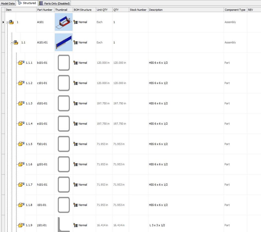

I'm try for read item number like a picture below and wanna get the data structure as per Structured View.
But I can't. Because the program read the ItemNumber as per Model data or Hierarchy in object history.
I wanna the data like this:
1
1.1
1.2
1.3
1.4
1.5
2
2.1
2.2
2.3
3
3.1
3.2
4
5
6
But I get actual data like this :
1
1.1
1.2
1.3
1.4
1.5
4
2
2.1
2.2
2.3
5
6
3
3.1
3.2

MechMachineMan
It has been like this forever.
Inventor doesn't internally resort the data based on the item numbering scheme you have set.
The internal order is based on the order in which the documents were added to the assembly (I think).
If you want to get a list by the bom structure, you should just be able to re-sort it by item number afterwords using a custom comparison. Or you could evaluate if you really need the program to do the sorting, and can just get by with some other sort method (ie; excel) afterwards.

@MechMachineMan : Thanks for your reply. Because it's impossible for Numbering component direct from Inventor. So I decide using Excel Spreadsheet in this case.

I tested provided sample and source code in Inventor 2019 and Visual studio 2017. The results are sorted as shown below. Can you please specify Inventor version that is currently using?

There was a change request (INVGEN - 6581) on this. It is fixed in Inventor 2019.

Hoping that below sorting code would help to sort items of Structured view.
Sub ListBomItems()
        Dim asm As AssemblyDocument
        asm = invApp.ActiveDocument
        Dim b As BOM
        b = asm.ComponentDefinition.BOM
        b.StructuredViewEnabled = True
        Dim bv As BOMView
        bv = b.BOMViews("Structured")
        Dim oSort As Dictionary(Of Integer, Integer)
        oSort = BOM_Sort(bv.BOMRows)
        Call ListItems(bv.BOMRows, 0, oSort)
    End Sub
    Function BOM_Sort(rows As BOMRowsEnumerator)
        Dim oSort As Dictionary(Of Integer, Integer) = New Dictionary(Of Integer, Integer)
        Dim oRow As BOMRow
        For i As Integer = 1 To rows.Count Step 1
            oRow = rows.Item(i)
            oSort.Add(oRow.ItemNumber, i)
        Next
        BOM_Sort = oSort
    End Function
    Sub ListItems(rows As BOMRowsEnumerator, indent As Integer, oSort As Dictionary(Of Integer, Integer))
        Dim row As BOMRow
        Dim i As Integer
        For i = 1 To rows.Count Step 1
            Dim key As Integer = oSort(i)
            row = rows.Item(key)
            Debug.Print(row.ItemNumber.ToString)
            If Not row.ChildRows Is Nothing Then
                Call ListItems(row.ChildRows, indent + 2)
            End If
        Next
    End Sub

But there's like jumping in looping system. Because some component type can't be read.

Below highlighted (red in color) was missing in previous code.
Sub ListBomItems()
        Dim b As BOM
        Dim bv As BOMView
    End Sub
        Dim oRow As BOMRow
            oRow = rows.Item(i)
        Next
        BOM_Sort = oSort
    End Function
        Dim row As BOMRow
        Dim i As Integer
            Dim oCompDef As ComponentDefinition
            oCompDef = row.ComponentDefinitions.Item(1)
            Debug.Print(row.ItemNumber.ToString & " " & oCompDef.Type.ToString)
            End If
        Next
    End Sub

Thanks and regards,
CHANDRA SHEKAR G
Developer Advocate
Autodesk Developer Network
Message 19 sur 22
abilabib
Dear @chandra.shekar.g :
Many thanks for your code and effort.
Case Closed.
0 J'aime
Message 20 sur 22
abilabib
@chandra.shekar.g. Many thanks for your code. My program is done Smiley heureux.
0 J'aime
