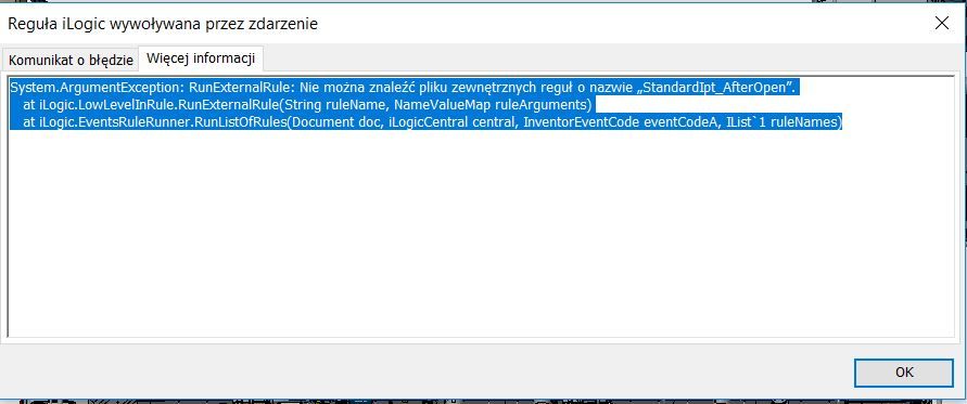

I have an issue while oppenning the .iam files.
Each time the files is opened the message box appears on screen with information as shown on picture below(it is in Polish but i provide translation)
Translation
Rule Ilogic triggerred by event
RunExternalRule: Can't locate external rules files named"StandartIpt_AfterOpen"
and then more info tab:
What can be possible reason?
Thanks in advance for any tips.

Hi.
You are missing an External Rule called "StandartIpt_AfterOpen" that is triggered after opening a document.
Either you locate the iLogic rule and add it, or remove the rule from Triggers.

yes, it is possible. Open Event Triggers dialog box (Ribbon Manage - group iLogic).
Then click on Options in Security group. There you can disable triggering all rules. Dont mind that "This Document" is highlighted, I just used Picture from the internet because I have Inventor in different language.
You have to do that on every computer if you are using more than one computer at your work.
If you have more rules which are triggered via event. triger, you can create rule, which removes only that rule, that is missing (I think this is also possible).

@Anonymous Depends on what version of Inventor he uses. The pic you have showed is for 2018 and forward i think.
If he is using 2017 or older, then its a bit different.
Either you disable all trigger by Untick the checkbox at the top. (Run these rules when events occur)
Or you select, in your case "After Open Document" and click on "Select Rules..." and remove the "StandartIpt_AfterOpen" rule.
