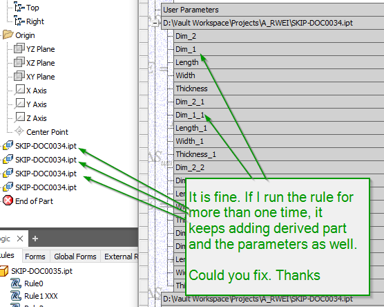

Message 5 of 10
RoyWickrama_RWEI
If I run the rule for more than one time, it keeps adding the derived part and the parameters as well,
Could you help to get around the issue. Thanks.

Message 6 of 10
HideoYamada
What do you think should be done when the rule is invoked multiple times?
Ignore the execution?

Message 7 of 10
RoyWickrama_RWEI
Thanks.
I got it around (using your guidance).

Message 8 of 10
HideoYamada
Does your code work properly when the document contains multiple derived part features?
I think there is an issue around "For Each XX" loop.
And try consider to use a type "Boolean" instead of "String" if the variable stores only "YES" or "NO".
It is fine for the time being.
According to following, I think that the 'sourceFullFileName' will be compared only with a name of the last oRefFile.
The code will work as you expect if the part document has only one DerivedPartFeature.
