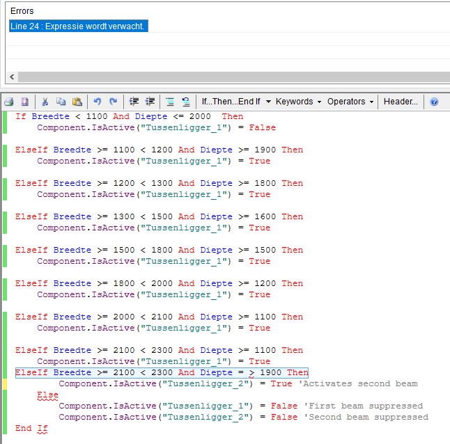

jostroopers
Hi Chandra
Thanks for reply
I have made some changes to the model.
I split the 'Tussenligger' to 'Tussenligger_1' and 'Tussenligger_2'  so that they are two separate parts.
I also split the windows to have separate parts.
Then I used your code.
I have adjusted this so that it fits the schedule.
However, I always get error reports from an Expression and I have to apply an End If.
However, I can not manage to solve the reports.
Mvg Jos
Youre drawings are as good as the symbols that compleet them.....

Message 7 of 13
jostroopers
If there are two 'IF' statements you have to end with two 'End If'!?
But i get still an error: ElseIf moet worden voorafgegaan door een overeenkomende If of ElseIf. (ElseIf must be preceded by a corresponding If or ElseIf)
When i delete Else in the first row the error disappears.
Mvg Jos
Message 8 of 13
jostroopers
It is stil not working.
I made a movie:
 https://www.screencast.com/t/Etv9cGz5qd
When i change 'Breedte' en 'Diepte' the model will not update correct.
Mvg Jos

jostroopers
Here is my code.
SyntaxEditor Code Snippet
If Breedte < 1100 And Diepte <= 2000  Then
	Component.IsActive("Tussenligger_1") = False
	Component.IsActive("Tussenligger_2") = False
ElseIf Breedte >= 1100 < 1200 And Diepte >= 1900 Then
	Component.IsActive("Tussenligger_1") = True
ElseIf Breedte >= 1200 < 1300 And Diepte >= 1800 Then
ElseIf Breedte >= 1300 < 1500 And Diepte >= 1600 Then
ElseIf Breedte >= 1500 < 1800 And Diepte >= 1500 Then
ElseIf Breedte >= 1800 < 2000 And Diepte >= 1200 Then
ElseIf Breedte >= 2000 < 2100 And Diepte >= 1100 Then
ElseIf Breedte >= 2100 < 2300 And Diepte >= 1100 Then
	If Breedte > 2000 < 2300 And Diepte  >= 1900 Then
		Component.IsActive("Tussenligger_2") = True 'Activates second beam
	End If
End If
If Breedte >= 2300 < 2500 And Diepte >= 1100 Then
	If Breedte >= 2300 < 2500 And Diepte >= 1800 Then
	Else
		Component.IsActive("Tussenligger_1") = False 'First beam suppressed
		Component.IsActive("Tussenligger_2") = False 'Second beam suppressed
	End If
End If
If Breedte >= 2500 < 2600 And Diepte >= 1100 Then
	If Breedte >= 2500 < 2600 And Diepte >= 1700 Then
	Else
	End If
End If
If Breedte >= 2600 < 2700 And Diepte >= 1100 Then
	If Breedte >= 2600 < 2700 And Diepte >= 1700 < 2000 Then
	Else
	End If
End If
If Breedte >= 2700 < 2800 And Diepte >= 1100 Then
	If Breedte >= 2700 < 2800 And Diepte >= 1700 < 1900 Then
	Else
	End If
End If
If Breedte >= 2800 < 3000 And Diepte >= 1100 Then
	If Breedte >= 2800 < 3000 And Diepte >= 1700 < 1800 Then
	Else
	End If
End If
If Breedte >= 3000 < 3100 And Diepte >= 1100 Then
	If Breedte >= 3000 < 3100 And Diepte >= 1600 < 1700 Then
	Else
	End If
End If
If Breedte >= 3100 < 3200 And Diepte >= 800 Then
	If Breedte >= 3100 < 3200 And Diepte >= 1200 < 1700 Then
	Else
	End If
End If
If Breedte >= 3200 < 3500 And Diepte >= 800 Then
	If Breedte >= 3200 < 3500 And Diepte >= 1200 < 1600 Then
	Else
	End If
End If
If Breedte >= 3500 < 3600 And Diepte >= 800 Then
	If Breedte >= 3500 < 3600 And Diepte >= 1200 < 1500 Then
	Else
	End If
End If
If Breedte >= 3600 <= 3800 And Diepte >= 800 Then
	If Breedte >= 3600 <= 3600 And Diepte >= 1200 < 1400 Then
	Else
	End If
Else
End If
iLogicVb.UpdateWhenDone = True
Mvg Jos
