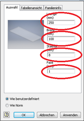

Message 7 of 14
Content Center Files are no iPart!
But you can add iParts into Content Center with user defined parameters.
In example, we have a pmma plate with a size of 500x100x8 mm as Content Center File.
500 mm,100 mm and 8 mm can be changed by input of new data. (Form below)
The data of length, width are used to generate filename and title and so on. Thats set in the familytable.
If I change the size from the 500x100x8 to 600x100x8 a new CC part with filename "pmma_600x100x8_001.ipt" is created.
We make custom designs and sizes. Thats why I need custom CC parts. Sometimes we have sizes like 822x610x600 mm or 1590x591x550 mm. And I dont want to set up a matrix with 2300x2300x10 variations in the familytable. That would extremly slow down the system and some sizes would never been used.
I want to open the form to replace part with a new size in ilogic. ( "Change size..." if you right click on an CC part)
Or change the size (marked red) directly via an ilogic form, without opening the Content Center form.
The code for an ilogic form would be better, because we have a mainassembly and open an ilogic form in this mainassembly to change sizes of the complete product.
The mainassembly works as a product template in Inventor and Vault and at the moment we simple need to copy the mainassembly, because all other parts are in CC and not copied.
I am sry, but my english isnt as good as it could be. Hopefully you understand what I mean.

Message 9 of 14
Thats not helpfull. Sorry.
I know how to add new parts in an assembly and I know iLogic Parts. But I want to change a Content Center Part with custom parameters.
I want to replace the 560x8x560 Content Center Part with the 615x8x510 Content Center Part in example.
The samples in helpfiles only use replace by row. But the custom content center part has only one row and generates new files without a new row in the familytable.
The manual way to do what I want is to right click on the part and select "Change size...". Then change the size in the shown screenshot (red marked).
I need ilogic or vba code to replace the part with changed sizes or open the form used to change it via ilogic or vba (right click "Change size...").

Message 13 of 14
Yes, but do not change custom size. I change some key parameter for a norm size.
• Get the target CC table row (yes)
• Get all parameters you need to change (yes)
• Get the new values (yes)
• Batch Edit the parameters (yes)
• Update Part (yes)
I need to access the parameters shown in the form (marked red) and change them.
As I said. Another way to solve the problem could be to open the form with an vba code.
I think that the form should be able to open. Even if no api exists for accessing the information in the form?
