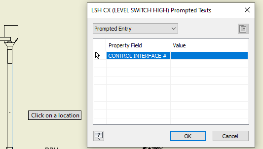

Used sketched symbols to create any custom prompted entry balloon you desire.
Create a new sketched symbol by right clicking "sketched symbols" and selecting "define new symbol" and sketch your desired shape of a balloon with a prompted entry text within. After saving and naming this new sketched symbol, find the this new sketch symbol in the tree under "sketched symbols",  insert in your drawing and snap to a line within your drawing view you wish to attach your balloon to. You will then be prompted for the custom text you wish to enter. After entering the text click on the center of the balloon and drag, the balloon will automatically have a leader attached. To edit the field text of the balloon you have inserted, right click after selecting the balloon and select "edit field text". for every new sketched symbol balloon you add to your drawing it will have unique prompted entry text.
