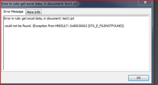

Does anyone has any clue why ilogic is not reading my excell file.
When I copy the path from the rule, it will open correctly when i paste it in file explorer.
Screenshots of error box are attached.
Ilogic below.

Message 2 of 23
MechMachineMan
GoExcel.Open("filename", “sheetname”)

JorisSteurs1246
I did include the sheetname in my first attempts but when it didn't work, I started reading in the online help where is says that if there is no sheetname in the path, Inventor thakes sheet1 by default. So I gave this a try also, but no luck.  ( Sheet1 is also the name of Sheet1 in my file, so that should be OK )

JorisSteurs1246
No adding this code didn't help, file is not recognized. Maybe its a Widows problem?  Are ther any tests I can do to pinpoint the issue?
Maybe it can be because of the fact that I upgraded fom office 2003 to Office 2010 while Inventor was already installed?

JorisSteurs1246
Copied the IPT and Excel file to another machine and still a problem although the error message is different.
Message 9 of 23
MechMachineMan
Well, what's the error there?

JorisSteurs1246
System.AccessViolationException: Attempted to read or write protected memory. This is often an indication that other memory is corrupt.
at Microsoft.Office.Interop.Excel.Workbooks.Open(String Filename, Object UpdateLinks, Object ReadOnly, Object Format, Object Password, Object WriteResPassword, Object IgnoreReadOnlyRecommended, Object Origin, Object Delimiter, Object Editable, Object Notify, Object Converter, Object AddToMru, Object Local, Object CorruptLoad)
at iLogic.GoExcel.SetCurrentSheet(String fileName, String sheetName)
at LmiRuleScript.Main()
at Autodesk.iLogic.Exec.AppDomExec.ExecRuleInAssembly(Assembly assem)
at iLogic.RuleEvalContainer.ExecRuleEval(String execRule)
Message 11 of 23
MechMachineMan
Try copy pasting the data to a new excel file on this new computer and
re-running. Looks like excel issues.

JorisSteurs1246
Did so already earlier,  but gave it another try right now, with this outcome.

MechMachineMan
Try this simple rule with a new excel file and see how that goes:
Dim Loc as String = "C:/" ' Change to actual file location
Worksheet = Loc
Sheetno = ("Sheet1")
GoExcel.Open(Worksheet, Sheetno)
GoExcel.CellValue("A" & 1) = "This is working"
GoExcel.Save
GoExcel.Close
newExcelApp = CreateObject("Excel.Application")
newExcelApp.Visible = True
newExcelApp.Workbooks.Open(Loc)

JorisSteurs1246
No luck....   strange that the same error occurs on 2 differntr machines

MechMachineMan
Indeed. Do you have multi langauge/cross language settings between your programs? Or is it all in english?

Message 16 of 23
JorisSteurs1246
I used to have on both machines Office 2003 ( DUTCH)  and W7  ( ENG )
On one machine I recently uninstalled Office 2003 and replaced it with  Office 2010 ( ENG).
Message 17 of 23

Message 18 of 23
JorisSteurs1246
No only this MS Office I´ve installed is in Dutch because the CD doesn´t give me an other choice.
So Inventor is, and always has been, installed ENG. It might be that MS is installing patches on my PC that fit the Dutch office but whenever I´ve the choice as a user to select a language I choose ENG.

Message 20 of 23
JorisSteurs1246
This ,of course, I made sure that the sheetname matchces the one used in the rule .
