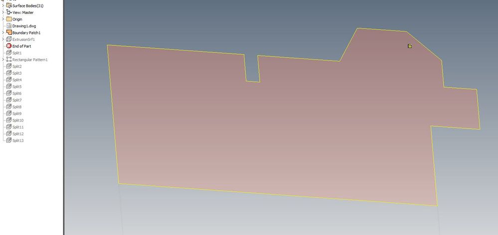

Hi everybody,
I have a surface with random boundary. I want to split it to many smaller surface. But i can not find out the way quickly.
Currently, I import a autocad file, create a boundary patch surface, create a rectangular sketch and extrude surface.
Split extrude surface. Pattern extrude surface to continue split.
But now, i can not split from pattern elements. How should i do ?
Thank you.
Here is my code.

Thank you for your help. Here is my picture. I split by hand in this file.

I want inventor split any surface with a rectangular.

Thank you for your idea. I opened your file. But maybe i am stupid. I don't understand what you mind ?
like my picture i uploaded , i want to split a surface with random boundary line.
My way is extrude surface and split mother surface tho many child surfaces automatically.
After saw your part, i dont understand how to solve my problem...
Thanks you.
