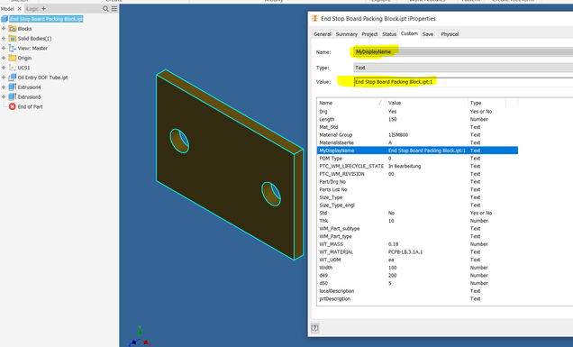

bradeneuropeArthur
First create a  Custom Property in each part in the assembly Called "MyDisplayName" and give this the values as per picture.
Than use this i-locig code to set each time you copy the value back to the default (Displayname)
Dim a As AssemblyDocument = ThisAssembly.Document
Dim ac As AssemblyComponentDefinition = a.ComponentDefinition
Dim ao As ComponentOccurrence
For Each ao In ac.Occurrences
	Dim d As Document = ao.Definition.Document
	Dim dps As PropertySet = d.PropertySets.Item(4)
	Dim dp As [Property] = dps.Item("MyDisplayName")
	ao.Name = dp.Value
	Next
Now the problem from the rename is away since the displayname is always static or overwitable with the "MyDisplayName" value of each occurence in this assembly.
Regards,
Arthur Knoors

Message 12 of 14
ikilic1461
Hello @bradeneuropeArthur  ;
I created a custom property in 7 parts which I got parameters in my assembly  as you mentioned "MyDisplayName".
But at the end I got this error . Then form didn't work.
I am also attaching model here.
MyDisplayName = Oil Entry DOF Tube.ipt:1
MyDisplayName = Interval DOF Tube.ipt:1
MyDisplayName = End DOF Tube.ipt:1
MyDisplayName = DOF Oil Entry End Flange.ipt:1
MyDisplayName = End Stop Board Packing Block.ipt:1
MyDisplayName = DOF Tube Support Board.ipt:1
MyDisplayName = Petal Washer Seal.ipt:1
Message 13 of 14
bradeneuropeArthur
I have got it working for you.
What you forgot is to add "MyDisplayName" to each compontent even it is an empty string.
Also changed this in the code:
	Try
	ao.Name = dp.Value
		Catch
		End Try
	Next
See the movie for explanation too

Message 14 of 14
ikilic1461
Even  if I applied to the all items I got en error again ;
There is something wrong or missing.
If possible , can you share your modifed file?
