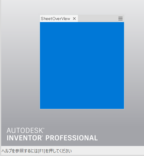

resizeNotWorking.pngIm creating an addin with a dockable window. It works fine but when the dockable window is floating it is not possible to rezise it anymore. (draging the edge does not work.)
i create the dockable window with the following code:
Form1 form = new Form1(inventor);
UserInterfaceManager uiMan = inventor.UserInterfaceManager;
docableWin = uiMan.DockableWindows.Add("###############", "###############", "###############");
docableWin.AddChild(form.Handle.ToInt64());
docableWin.Title = "SheetOverView";
docableWin.ShowTitleBar = true;
docableWin.DisabledDockingStates = DockingStateEnum.kDockBottom | DockingStateEnum.kDockTop;
docableWin.SetMinimumSize(200, 150);
if (!docableWin.IsCustomized)
    docableWin.DockingState = DockingStateEnum.kDockRight;
    docableWin.Visible = true;
form.Show();
any on has some idea why it does not work or what i can try to make it work.

The Dockable Window which is created with follow code is resizable in my enviroment.
public void Activate(Inventor.ApplicationAddInSite addInSiteObject, bool firstTime)
    // This method is called by Inventor when it loads the addin.
    // The AddInSiteObject provides access to the Inventor Application object.
    // The FirstTime flag indicates if the addin is loaded for the first time.
    // Initialize AddIn members.
    m_inventorApplication = addInSiteObject.Application;
    var inventor = m_inventorApplication;
    // TODO: Add ApplicationAddInServer.Activate implementation.
    // e.g. event initialization, command creation etc.
    //Form1 form = new Form1(inventor);
    Form form = new Form();
    form.BackColor = System.Drawing.SystemColors.Highlight;
    form.FormBorderStyle = FormBorderStyle.None;
    form.Show();
If you can resize the dockable window with this code, the issue will be depending on Form1.

Thank you for your reply but it did not get it to work. I used your code and created a new form (and did not change any thing on the form.) but it still does not resize. Do i need to change some properties of the form?

@bradeneuropeArthurI tryed your code and I tracked when the event is triggerd but it did not seem to be triggerd when the i tryed to resize the dockable window. So no luck with that event.
@HideoYamadaThank you for sending the example addin. Your example addin was also not resizing.
i discoverd that it is possible to resize my dockable window in the following way:
  • Undock the model browser
  • Put the model browser and my dockable window in the same frame.
  • Resize the model browser.
  • switch to my dockable window.
  • now its possible to resize......
that is far from how it is supposed to work. Im starting to wonder if the problem is my computer. (Also because the example of @HideoYamada does not work.) i will test this later on my job. If you have more ideas that they are still welcome. anyway i will keep you posted
