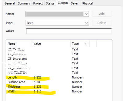

is it possible to create an iLogic that will assign a combination of custom properties to each part in the assembly?
For example, a part in an assembly has these custom properties
Value: 82
Value: 100
Item.FillWorkpiece.Material.Thickness
Value: 18
I would like to start iLogic in the assembly environment and for the description of the part to be:
100 x 82 x 18

<span;>Description
<span;>Value is <<span;>Item.FillWorkpiece.Width> x < Item.FillWorkpiece.Length>×
<span;><Item.FillWorkpiece.Material.Thickness>
<span;>No code needed</span;></span;></span;></span;></span;>

@kresh.bell, This will add the formula to the Description iproperty
iProperties.Value("Project", "Description") = "= <Width> x <Length> x <Thickness>"

Curtis_Waguespack
@bradeneuropeArthur wrote:
And no coding needed at all!
I think that depends on the situation. If we are working with a template, then adding the formula to the description iProperty in the template provides a no-code solution.
If we're wanting to work with many existing files, then adding the formula to the description iProperty with a line code like this would be more efficient.
