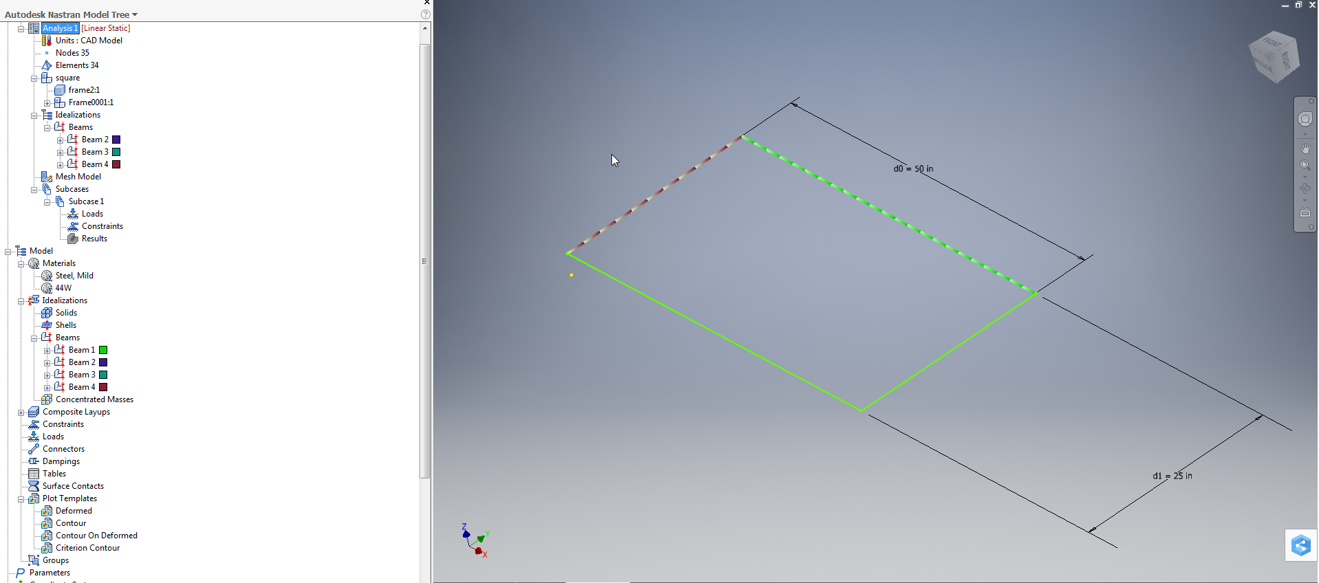

I made a rectangle using fram generator in Inventor. I use the function reuse in order to have only two part number as the lenght is the same on each side. When I try to mesh the, Nastran don't mesh the reused structural member, only the original one. I can't put any load or constraint at vertice cause the rectangle is not entirely meshed. I can't find a way around this problem.
Does anyone know a solution?
Thank

Hi @Anonymous
I have a question about your model. In the CAD environment in Inventor, are there parts with the same name? In particular, the parts that do not mesh in In-CAD, do they have the same name?
When you insert a duplicate part, Inventor should give it a different name (something like Part:1, Part:2, Part:3). I encountered an issue where the duplicate part was not given a different name, and that caused a problem with In-CAD.
I am not an Inventor expert, so I do not know how to create the other parts and create a new name. If you learn how to do that, please let us know!

Inventor give a different name...
2018-09-17 12_19_44-Mise à jour _ Demande de support T20180904.0023 - david.parebissonnette@hydro-mo.png

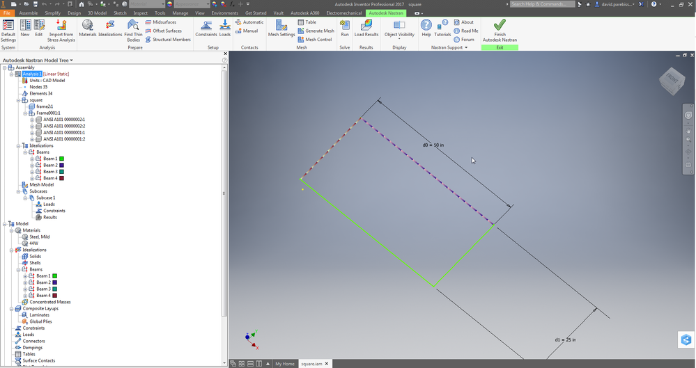

But its easy to reproduce the project. You draw a rectangle in a sketch. Use the frame generator to assign tube to one short and one long side. Then you use the fonction reuse for both opposite side. Then you open Nastran-in-cad and make sure the frame are considered as structural member and then mesh it.

I tried with another computer and it still doesnt work. Its weird. But anyways, as it seem to be a probleme between Inventor Frame generator and Nastran-In-cad, you can make a test easily with only one reused member, as a said in the last post. Or you could give me an email adress so i could send you the file.

I am seeing the same behaviour. Reused frames are not being meshed in Nastran In CAD. I have attached a zip file of the following model.
If you create all the frame members individually Nastran In CAD seems to work fine and mesh all the components.

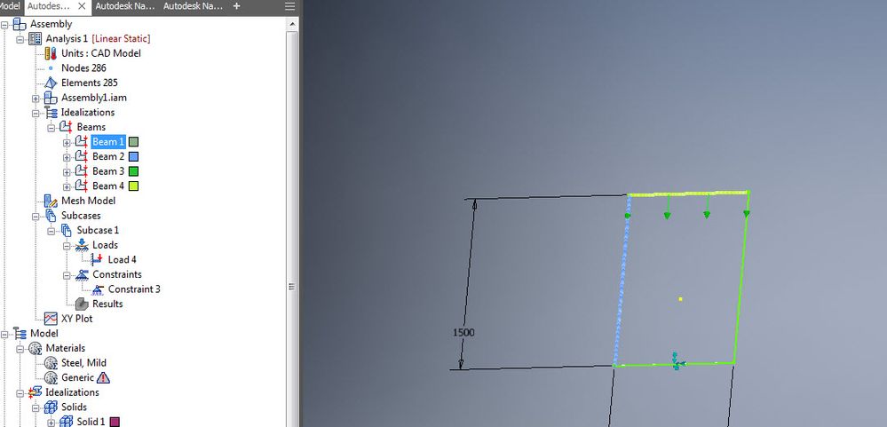

I have this problem.  Frame generator gave two different length W8x40 beams the same name in the tree, W8x40:3.  Now Nastran will not mesh the second W8x40.  Using 2020.  So how do i fix the issue or rename.  Inventor will not let me simply change the tree name.  Will it be necessary to reconstruct the member each time and i have not even tried that yet?  Is there a simply fix?
ler3
OK it was easy enough to just delete the member and reinsert with frame generator.  It then made it W8x40:16.  Hope this gets fixed.
