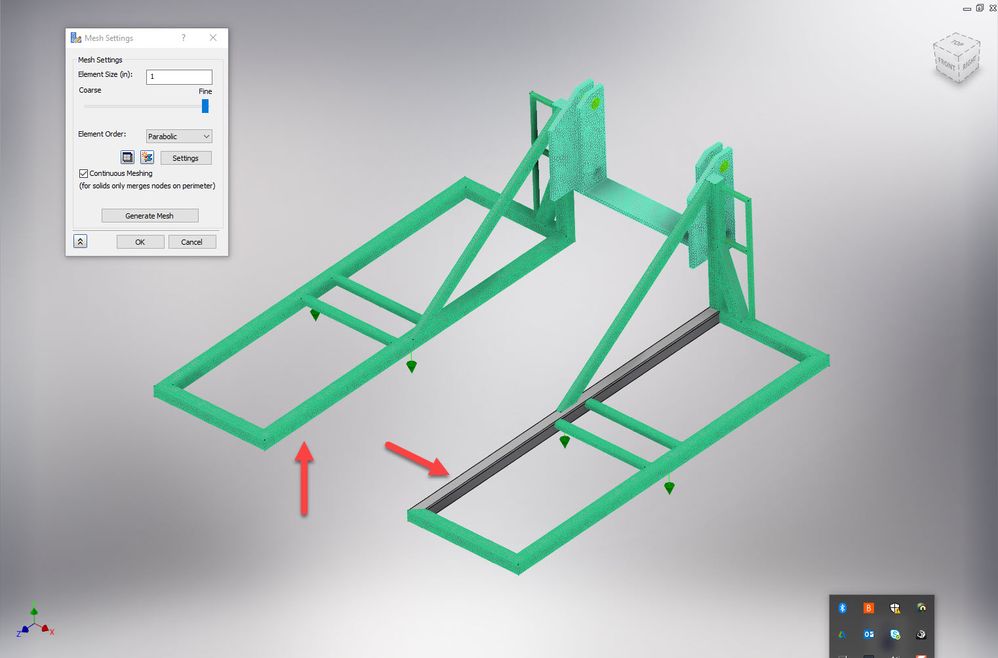

I'm new to Nastran but have used Inventor's simulation for years.  I'm wondering if there is any way to reliably arrive at a mesh that works?  The default settings always fail but no feedback on why is given.  Sometimes I am able to get things to mesh by adjusting the tolerance (in a blind trial and error sort of way) and sometimes not.  I have assemblies that have the exact same part (see screen shot) and one meshes and the other fails!  I'm wondering how that's possible?  The standard Inventor simulation environment has no problem with it.
The documentation is very little help.  Does anyone know of a procedure that would help arrive at a working mesh or is it just shooting at a black cat in a dark alley that may or may not exist?
These are the same part.These are the same part.

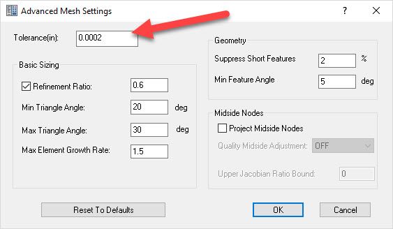

Before I updated to 2019.1.1 I was able to get it to work by changing the tolerance to .0002 (just a blind guess as there seems to be little info on how this really works and what a valid range of values would be).  Now that I updated, this won't even work.

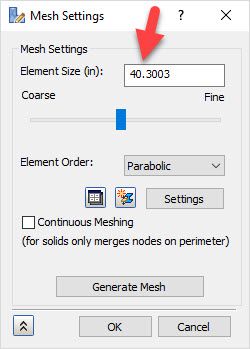

The default element size seems to make no sense.  It starts out at about 5" for an assembly that has 1.5" HSS in it.  If I use the slider set mid way it says 40".  Seriously?
I've tried adjusting mesh size, refinement ratio, min and max angle, growth ratio, suppress short features, min feature angle and midside nodes to every combination I can think of to no avail and since there is no feedback I don't know if I'm getting any closer or not.  Obviously, if we want to use this we can't spend all day playing with meshes.

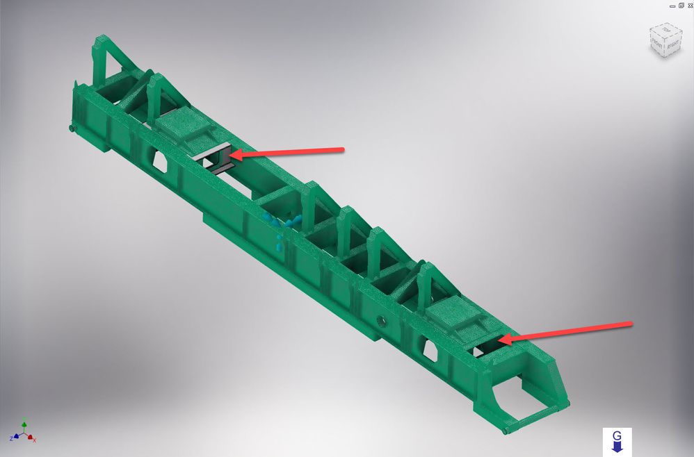

The assembly below has identical parts that are even oriented the same direction but some fail and some don't.
If there is any way to consistently get a mesh to work, I'd really appreciate hearing it.  Thanks.

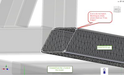

I was misunderstanding your description that the parts were "copied". I assumed that you meant they were copied in the assembly, or multiple instances of the same part were added to the assembly. They are actually different part files that have similar (but different) commands used to make them, so they are different parts.
  • part 000074154.ipt will mesh
  • part 00074155.ipt will not mesh. When I try meshing this part as shell elements, the white edges (see image below) shows where the faces are not knitted together properly. There is no particular reason why; that's just the way math works.
Problem mesh area.Problem mesh area.
So you open the part that does not mesh (00074155.ipt) and rebuild it ("Manage > Rebuild All", and I usually do "Manage > Update Mass" for good measure). Then in the assembly you can do "Manage > Update" to make sure the assembly has all of the changes. Then the model will mesh in In-CAD.
I assume the same rebuilding of the parts will fix the more complex model, too.
