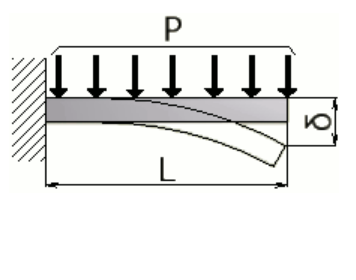

This time, I tried to perform the thermal stress analysis of a three-layer cantilever.
There is a temperature difference between the first layer and the third layer.
When I analyzed it, a model was displaced in a horizontal direction.
Intuitively, the model is displaced in vertical direction because of the temperature difference between the first layer and the third layer. (Like below figure)
I think this result was not correct.
I just started simulation at Nastran In-CAD and using Inventor, so I want you to give some advice.

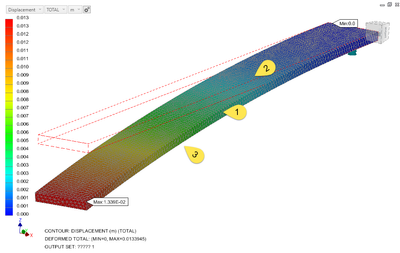

The results indicate that there are constraints applied to the "free end" of the beam. (See Figure 1 below.) I know that you did not apply any constraints there, so this indicates that the analysis is adding the constraints by mistake. My guess is the very thin strips on the top and bottom are causing the problems. (If you look at the mesh of the thin surface, you can see that the thickness was not preserved in the mesh, so it is wrong to begin with. The mesher just is not designed to create a solid mesh on a part that is so very thin.)
Figure 1. Original analysis with three solidsFigure 1. Original analysis with three solids
The overall model size is 125 by 1250 mm. My suggestion is to not model the thin strips (only 0.025 mm thick) on the top and bottom using a solid. In fact, you should not even include solids 0.025 mm thick in the model. The entire analysis can be created by using one solid with the dimensions 125 mm wide by 1250 mm long by t mm thick. (See Figure 2.)
  1. create one idealization using solid for the solid aluminum core.
  2. create another idealization using shells for top surface. The thickness of the shells is 0.025 mm which you enter on the idealization dialog. You will select the face on the top of the solid for this idealization.
  3. create another idealization using shells for the bottom surface. (Actually, the two shells can be in the same idealization since the properties are the same.)
If you set the shell idealization to use triangular elements, then no contact is required between the shell and solid because the mesh will automatically match. (The same geometry is used by the solid idealization and shell idealization, so the mesh is the same.)
In other words, thin "solids" should be analyzed using shell elements instead of solid elements. Depending on the geometry, you can create the shell elements by creating surfaces in the CAD model, or converting solid parts to shells using the "Prepare > Offset Surfaces/Find Thin Bodies/Midsurfaces" command in In-CAD, or just by selecting faces of the model (as in this example).
Figure 2: Three idealizationsFigure 2: Three idealizations
Let us know if you have any questions.
