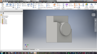

there is already this feature i have shown the steps to achieve this
first start with your body as shown
then draw the sketch of the slice you wish to take
click  on slice in the 3d modeling tab
click on the bottom of the three buttons on the left of the window that appears and then select the solid and the sketch in the appropriate
places
you should get something like this
then move the solid you have out of the way using the modify move command
and the final result should be
hope this helps Smiley Happy
