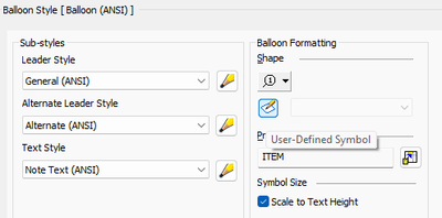

snguyenSWVMS
There is a way to add (QTY.) to balloon but I use it for long time and I hope Autodesk come up an automated to incorporated into the balloon command like Solid Work doing for long time.
The way I use to do is design symbol in drawing template link the balloon qty. in the text after insert the balloon then insert the symbol it snap around the 4 point of the balloon circle.
It is an extra step to do.
I hope Autodesk will add this to balloon step turn on the qty. or not turn.
