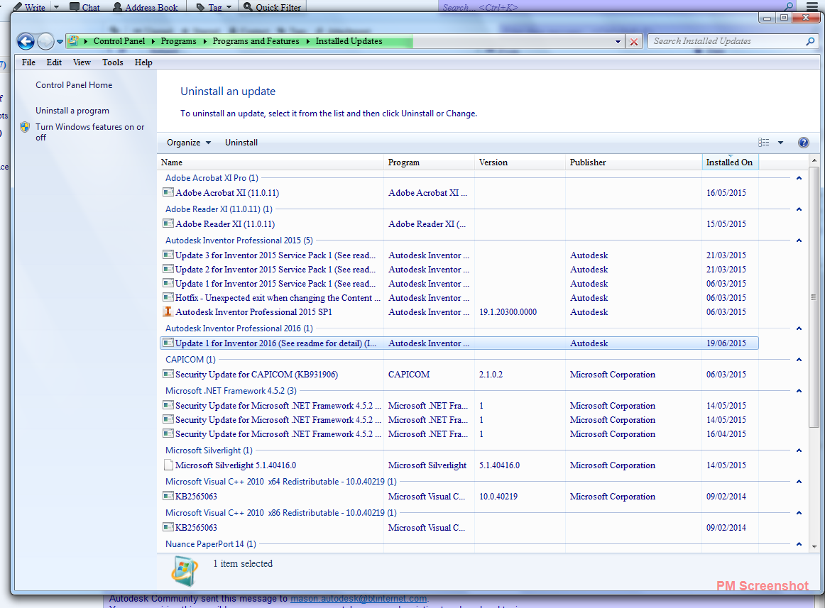

Paul-Mason
On Win 7 Pro it veiw update on the LH side, anyhow after clciling on that I'm NOT seening Update 2 as installed :-
Strange that 2015 is still showing as it was un-installed when I installed 2016, so those updates should not be showing as installed.

DarrenP
Mine shows up Inventor 2016
also shows up in Add/Remove features
so something else is happening

Paul-Mason
So I eventually got this sorted, by un-installing, rebooting and re-installing the main Inventor program, run once close down, MANUALLY installed the update, now showing as installed, WHAT A MUCK AROUND, I THINK this is exactly what I did with update 1
