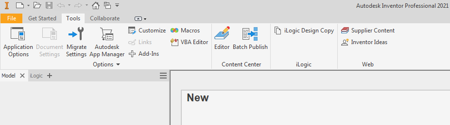

I have recently installed Thread-modeler and Vault Client in my computer but they do not show up in the Inventor. Please help me in figuring out how to,
1. Add Vault extension to the Inventor application.
2. add thread modeler Add-in.
I'm not sure if these errors are related but my App manager in Inventor fail to load in the application, and throws an error " Unexpected error when loading dialog".

johnsonshiue
Hi! What release of Inventor are you on? Have you applied the updates? I suspect this might be due to lack of certain shared components to support later Win10 builds. Please install the latest Inventor updates applicable to your release.
Many thanks!

vinayL7WQ5
Hello Johnson,
Following your advice,I have updated all my Autodesk applications to 2021 versions and currently, I'm able to access Vault in my Inventor. Thank you for the suggestion.
However, I'm still not able to load the Threadmodeler Add In. It does not show up in the Add-In Manager and I continue to receive the same "Unexpected error when loading Dialogue" error from the app manager.
Please advice.
Thank you
