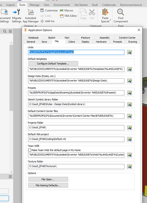

Message 8 of 17
jcharronYJF55
Where do I pull up this menu of options? Thanks
Message 9 of 17

Message 10 of 17
bradeneuropeArthur
Find it here:

Message 11 of 17
jcharronYJF55
Excellent
