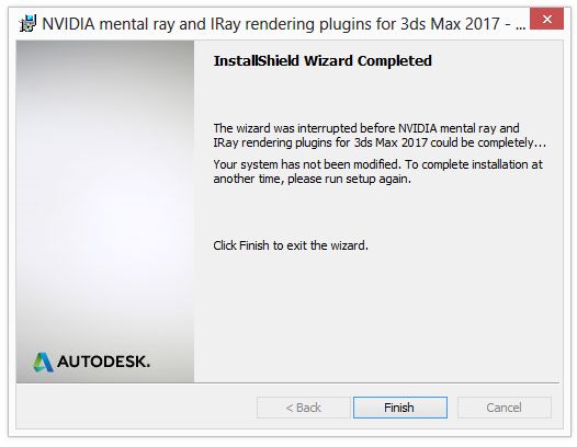

Hello everyone!
I am facing a critical problem. Just trying my hands on new 3d studio max 2017. After doing a full installation, I noticed that the Mental Ray renderer was missing from the render list :
Also, please note that while installing the 3d studio max 2017, I DID NOT got any option for installing mental ray plugin (which usually shows up in the install list) :
I did some research and came across the following threads highlighting similar problems:
http://forums.autodesk.com/t5/installation-licensing/3ds-max-2017-mental-ray-install-issue/m-p/62864...
http://forums.autodesk.com/t5/installation-licensing/mentalray-dll-not-loading-max17/td-p/6282811/hi...
http://forums.autodesk.com/t5/3ds-max-forum/how-do-i-install-mentalray-render-engine-in-3ds-max-2017...
And as one of the solutions in the above threads, I downloaded the Mental Ray folder and tried doing a standalone install on mental ray,
but unfortunately I get the following message in the end:
And I noticed that NO files are copied in the installation folder after this message. Which clearly means that nothing is installed.
However, I would also like to state that when installing from the MentalrayPlugin Folder (by clicking the MentalrayPlugins2017.msi file, the package gets installed fully but Mental Ray DOES NOT shows up in the render settings.
I am not sure why I am not able to install from Mentalray2017.msi file and get the above error!
I am on Windows 8 (not 8.1), could it be because of that?
I have disabled/uninstalled ALL the anti-virus, spam-ware programs.
Hope to receive some help on this!

Message 47 of 53
JezEmin
Morice,
In 3dsMax go to Configure System Paths (under Customise) and add the line under the "3rd Party Plug-ins" tab;
"C:\Program Files\Autodesk\3ds Max 2017\Plugins\NVIDIA\Plugins\"
That should fix things for you (I too had installed the rar files and nothing was fixed until I added that path above".
Hope that fixes things 🙂

Hi.
I had sort of the same problem although the error message only referred to mrmaterialattribs.gup as the picture shows. I tried all the previous suggestions but none of it worked. I searched inside the 3ds max installer and found the Mental Ray installer and the .gup file. I ran the .msi file and that fixed the problem!
You can find it in: 3ds max 2017 root folder\x64\MentalrayPlug\MentalrayPlugins2017.msi

artisticpixel
@marcin_perek wrote:
Try to install both of those files, Mentalray2017.msi it's not enough, I found them in installation folder
c:\Autodesk\WI\Autodesk 3ds Max 2017\x64\MENTALRAY\Mentalray2017.msi
c:\Autodesk\WI\Autodesk 3ds Max 2017\x64\MENTALRAYPLUG\MentalrayPlugins2017.msi
Kudos to you ! This is the only advice that worked for me
