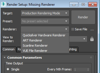

When opening an existing Max16 file (with mental ray as render) in 17, I get missing dll errors for mental ray.  The path in 17 is set to the location where the files are located, but they don't to load.
Obviuosly I can not select mental ray as the render in 17. So I have been playing with ART but not getting the same results as MR gives.  I need to stay with MR to finish current projects.  More time spent with ART and adjusting settings might help....we will see.

Thanks for the offer tony.su.  Not just existing files show the error, but I can start a new file and load my maxstart.max file and receive the error.  (see attached) This file has mentalray set as the renderer, so obviously the error shows.  If I start a new file with a generic setup, no error msg is generated but MentalRay is not listed as an available renderer....neither is Iray.  (see attached)
The plugin manager shows them as loaded and a valid path.  (see attached)  For whatever reason the dll's are listed as missing.

I did as you requested and uninstalled Max and the Nvidia plugins.  When running the install on Max I did not see the option to install the Nvidia plugins.  I completed the Max install and then looked at the installed programs - Nvidia MentalRay plugins are installed.  Ran Max and still no MentalRay rendered to select.  I ran the Mental ray standalone installer you sent yesterday, repair and then loaded Max again.  Still can not see mental Ray as an option under Renders.
More ideas to try?

Ha! a clue.....  🙂  .......after a closer look, what I see installed are the "feature plugins" at 4.26mb, what I am missing is the "rendering plugins" at 228mb.  I don't beleive the rendering plugins have ever been listed as installed, just the "feature".  Can I get an installer for the rendering plugins?

Success!!  That file did the trick.  I will play around and see if all is well, but initially all loads and I can se the MentalRay renderer.
