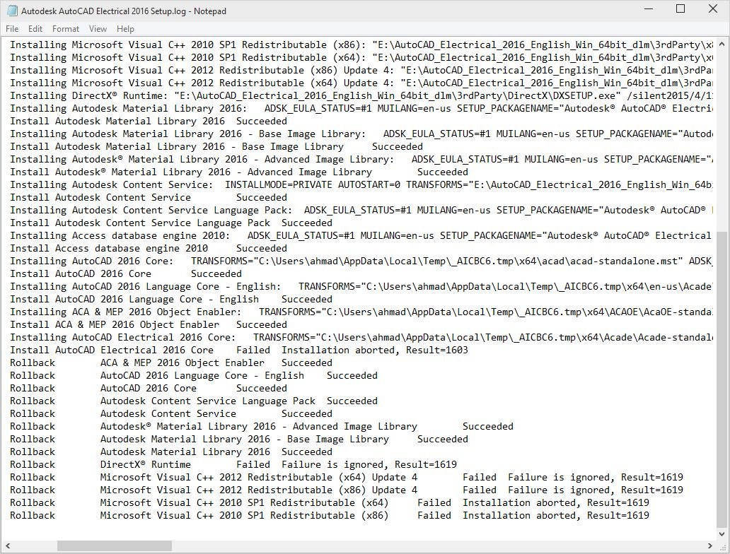

Hello guys;
When I install the AutoCAD Electrical 2016 on my PC (Windows 10 Build 10041) i got this error:
Install AutoCAD Electrical 2016 Core Failed Installation aborted, Result=1603

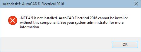

If it still errors for 4.5, you might have to remove it altogether from the setup.ini

@TravisNave
I edit my setup.ini
But again, the error 4.5.

For installing AutoCAD 2016 on Windows 10, pls change the registry key according to the link below. I can installed AutoCAD 2016 on Windows 10 successfully. Hope its helpfull.

Hi there,
go to " Regedit " ,, and then go to
"HKEY_LOCAL_MACHINE\SOFTWARE\Microsoft\NET Framework Setup\NDP\v4\Client"
when u get the ownership of the "client" folder , change the key " version " to "4.5" and start installing,
when u finish installing , u can change this value back.
If, when change you get this error;
"Cannot edit Version: Error witing the value's new contents."
with the following software Open your registry lock and try again.
when u finish installing , u can change this value back and lock again.
