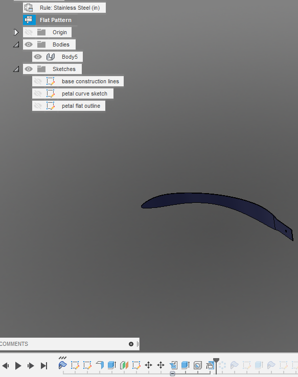

I have a curved sheet metal part that will unfold.
Once unfolded, I cut a shape and add a hole.
I want to make a flat pattern for laser cutting, but it errors on this operation, saying there is a compute problem.
Workflow is in screen cast and f3d is attached. Thanks in advance!

I tried this suggestion - using cut instead of intersect.
I am able to unfold but I am still unable to export a dxf.
Any ideas why?
