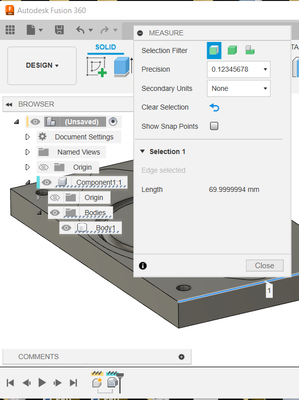

Hey guys, how to change this oval shape lid into square and making it fit into the chamber size with four screws if it is ok to make video for that I really appreciate it. Please see the attachment.

The dimensions are not correct the lid ID O ring groove is 52.091 and i want  52.00 mm and OD 59.909mm and i want 60mm
For the well O ring the issue is the same they are not exact.
I asked for the lid but i found they were changed
The  O ring groove needs to be 52mm ID and 60mm OD thanks

My issue is with O ring groove it has to be 52 ID and 60 OD mm

Why did you create a 0.00278184 step in your geometry?
How will you manufacture geometry that is 10.0089604?
