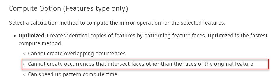

I do not believe this is a bug.  Mirroring the Emboss Feature violates the Mirror rules listed in the Fusion 360 help.  You have to agree the Emboss feature intersects more faces than the faces of the original feature.

It is ok for Fusion 360 not to create the geometry. It is not ok to hang indefinitely! @Phil.E can you record this as a bug please?

I wasn't aware of the limitation, but like @TrippyLighting says, the bug is that it hangs, potentially leading to loss of work. The expected result would be that Fusion shows an error and I can change the compute type and continue my work.

Agreed with you this should a problem for hang issue. I have logged an internal defect(FUS-148578) to track this problem. Thanks for reporting it!
