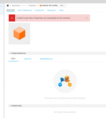

Hello, with the May 15th, 2026 update for autodesk fusion 360, the custom properties I had created for my components were lost, and on top of that, they are now locked as read-only, so I cannot update or edit them anymore.
This is a huge problem because I have hundreds of files with thousands of properties that I can no longer access or even attempt to fill in again.
I have tried every solution suggested by the assistant included in the software, and none of them worked (trying to change the properties from the Autodesk Web Hub, switching the design to the new hybrid type, changing the part number of the main component, checking that no component is derived or linked). Nothing works, and I cannot find a way to fix this.

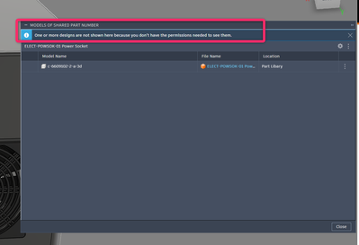

where is the fix @emily.caulfield ? I have a component that apperantly is a SPN. but it would not let me isolate it or change the name. I get only garbage when I try to generate a BOM with wrong part names/numbers. also when I try to find out where the other component is it just tells me I don't have access. COOL , but it does not tell me which project folder so I can request that access...nihil. How do I find out when there is just no INFO?
