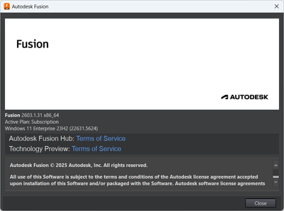

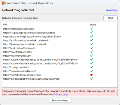

butch_berney
I have the same problem as in the original post. The constrains feature is not showing. I have cleared the cache and restarted Fusion twice. The Service Utility is all green *except for "launchdarkly".
Any hints on what is preventing the launchdarkly service from starting?...or how to get it to start?

sibashis.bishi
Hi @butch_berney
can you please check if your firewall or network is not blocking launch darkly access. More details: Link

Message 12 of 22
sibashis.bishi
Hi @butch_berney
Can you please update you fusion to build 2603.1.28. You will be able to access the constrain component feature.

Message 13 of 22
butch_berney
Hi
It looks like I am on 2603.1.15, but when I "check for updates" nothing newer shows up. I'm guessing there is a way to find the newer version but I looked around the menus and didn't see it. Can you point me in the right direction?

Message 14 of 22
butch_berney
It's certainly possible that something is blocking that service, but I don't have access to modify firewall settings on my work computers. This is controlled by IT, and in my experience, they are not so interested in modifying the configurations...particularly for an issue that only affects a single user (or maybe a few users) out of a population of 20,000 (or so) employees. I can't say that I blame them.
Let's see if the newer build (once I find out how to access it) mentioned in your other post fixes the problem.

Message 17 of 22
swapnil.hamdapureDDSVZ
Hi @butch_berney Sorry for the confusion caused. The fix is not available to the production build. It's currently with the Insider build. You can access the Insider build by joining the Insider program. https://feedback.autodesk.com/key/Fusion360Insider

Message 19 of 22
Hi @butch_berney The new update is available. Can you please check at your end and let me know if its working or not?
Message 20 of 22
butch_berney
Update is installed, and the constraints appear to be active. The "launchdarkly" service is still blocked. Not sure what that affects, but at least the constraints are showing now.
