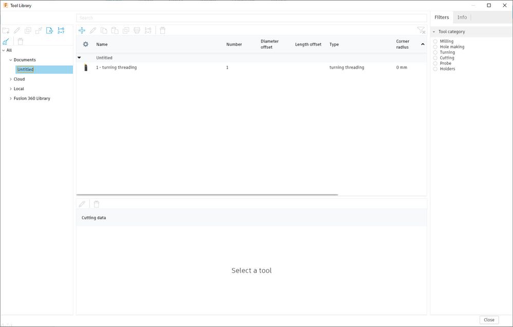

Marco.Takx
Hi @slickiii<
I see the same behavior. But you can solve it to close the tool library and re-open it.
@jeff.pek, can you take a look at this?
Create a Threading Tool and it ends up Yellow (See below)
After close down the tool library and re-open it, the tool is Black again.

ParhamsMachine
I gave it a try, but unfortunately no luck. I even tried closing fusion down and restarting, but I just cant seem to get past it.

seth.madore
Does this happen with the old Tool Library? You can turn off the new library in the Preferences > Preview Features
Seth Madore
Message 7 of 12
ParhamsMachine
Shutting off the new tool library got it to work, thanks!
