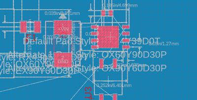

Why does this layer keep turning on???
I click the eyeball and turn it off...5 minutes later while  placing (or moving?) PCB parts (or possibly working on the schematic), I see it has come back on!  I want it  off and to STAY OFF.  When on, it throws about 10 pages of text all over the board layout---dimensions, numbers, pad sizes, and other stuff I don't need to see.  It keeps mysteriously turning back on, after a dozen times this gets very irritating.

here is an example...doc layer turns back on over & over & over by itself-- how do I turn it off and KEEP it always off???

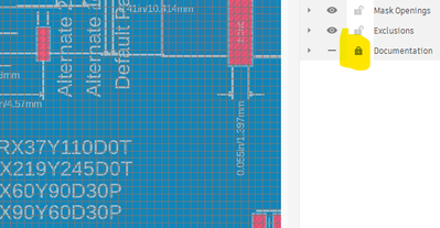

here it is as desired with it turned off:

If the PCB has the top doc layer off, and in the schematic I place a component from MY own fusion lib for the project...as soon as I double click the component in the schematic place components menu, the PCB top D2 doc layer eyeball lights up, but no board messy text  shows.   After I drag and place the clicked part on the schematic, the board fills with text (big monitor has the board & main fusion and the smaller monitor has the dragged out schematic).

I also tried  locking the entire document  section with D2 turned off... still same result (obviously it wasn't locked!)
Even if I use a single screen, the same thing happens (when I click on the brd tab, it shows as messed up), so it is not a docking issue.
How can simply clicking on a component in the  place component listing cause D2 to turn on (even when locked!)
