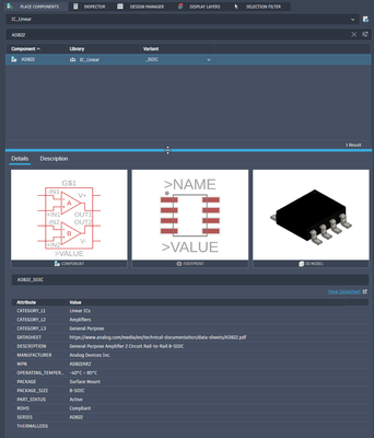

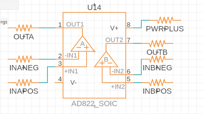

FIY there is a mistake in the IC_Linear library that is provided with Fusion 360, on the AD822 SOIC schematic component, pin 3 ad 2 are inverted compared to the manufacturer provided datasheet. One of my designs for which I disdn't check confirms that the Datasheet is the correct one.

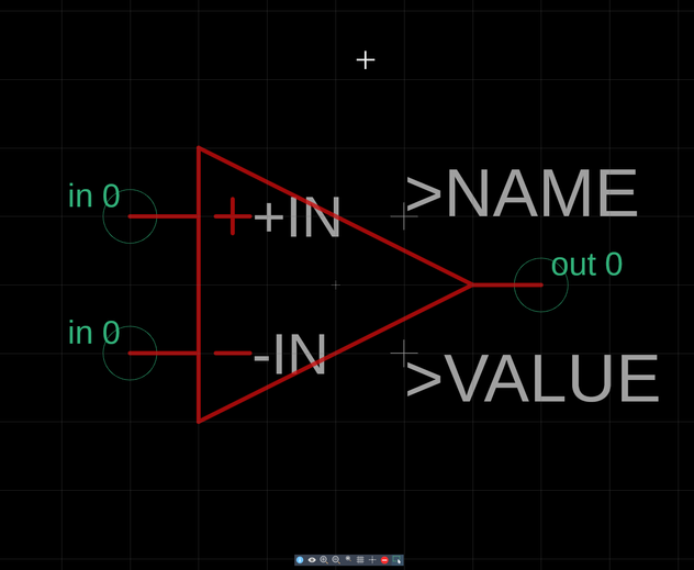

This issue can also be found in Symbol: "OPAMP-1" of the same IC_Linear library.
Pin + and - are inverted, which leads to wiring all TL072 inputs in reverse!

They are inverted as they are labeled + & - but the labels position don't match the pin names,
in the image notice the pin name is "-IN" but the pin selected is the one next to the + label.

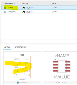

I don't see an issue (unless recently got fixed):
Notice everything matches up perfectly
YES you do have to verify the symbol pins map to the proper pads  --otherwise SEVERE hidden chaos

For AD822, the pin-to-pad mappings are correct, and the symbol itself is also correct. However, it differs from the datasheet representation because the datasheet uses positional pin placement, whereas the Fusion libraries use functional pin placement.
For the "OPAMP-1" symbol, the + and signs were inadvertently swapped.
However, the pin names and pin-to-pad mappings were correct.
This issue has been resolved in the latest v34 release.

Maybe confusion---this (correct) symbol came directly from the fusion-provide lib:
there is no error whatsoever with this part.
what part are you showing in msg#9??

MSG#9 shows the "OPAMP-1" symbol in the latest IC_Linear library which is v34.
Here is the latest version of AD822
@nnovotney The one you are showing is a previous version of the same part.
