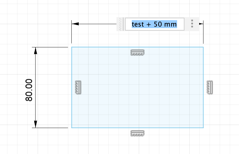

jeff_strater
@laughingcreek thanks for the pointer.  However, there is one subtlety here:  Fusion distinguishes an "expression" from an "equation".  An expression is just a math phrase that can be evaluated statically.  An equation is a math phrase that includes a reference to another parameter.  The "fx:" is only shown for equations.
expression:
equation:

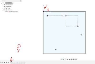

TrippyLighting
Something that strikes me as odd is that the very fist sketch, which is also the very first feature in the timeline has purple geometry in it!
Purple sketch geometry is projected geometry, which is still linked to the original object (edge or other sketch geometry from another sketch) it was projected from.
However, it being the first feature in the timeline there is no 3D object or other sketch that it could have been projected from, so how did that get there?
That is before I have even edited the sketch to look at how it is constrained and dimensioned.
Edit: That same purple geometry is part of every sketch in the design, but apparently it can be deleted without causing a problem. Unfortunately we don't have "link inspector", or a tool that would allow us to see what the projection is linked to.
