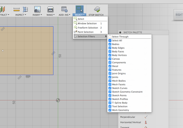

I would check your selection filter. That is the only way I could reproduce happening in your video. Other wise what you are doing should work and you definately don't need to delte the construction lines that define the center to resize the rectangle.
Hope that helps!

Message 8 of 17
scampa123
How do I delete the constraints? Which icons are the constraints?
Message 9 of 17
scampa123
What should my selection filter be?
Message 10 of 17
whats the video in my first reply "link"   ;-D
filter = sketch geometry constraineds.
drag select all and delete.
Message 11 of 17
and focurse remember to turn ALL on afterwords
Message 12 of 17
I would leave it on select all until you have a reason to be specific. It can come in realy handy to only felter selection to certain types of geometry some times but I leave mine on select all 90% of the time.
