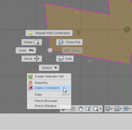

The full text of the item you refer to, I believe, is:
  • Previously there was no way to delete a coincident constraint from the context menu. The only way to delete the constraint was to select the constraint glyph and hit the DELETE key. Now there is an option in the context menu for you to easily delete constraints.
So, this is specific to deleting the implied coincident constraint when one or more sketch lines share a point.  Now, if you right click on the shared point, you will see this:
This is new for this update.  It's just a quicker way to break lines apart.
